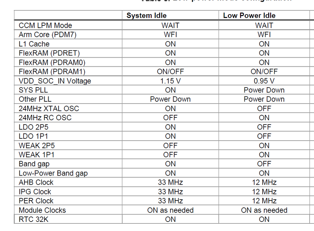

according to AN12085 the system pll will be powered on in System Idle.
Looking at the power_mode_switch_bm example it looks like we have to set every clock divider and system pll setting manually in code. The same is true for the Low Power Idle mode - every PLL gets shut down by software and not by hardware.

  1. Why can't we decide which clock will run at which frequency during system/low power idle if we have to turn off everything manually in code? (according to AN12085 AHB, IPG and PER clocks will be set to 33 MHz in System Idle)
  2. How can I turn off the CPU if it is not needed anymore (Idle Task is running) while our used peripherals (e.g. SPI, UART, FlexSPI, ADC, USB, eDMA) keep running in background (they still have work to do) and do their tasks. Some peripherals are running asynchronously to each other so waiting for all of them to finish before entering low power makes no sense.
    In other words how can I put the CPU in a Wait for Interrupt state while keeping all peripherals running and not changing their settings (which would only be possible if they are in an idle state)?
It is not possible. The reason is that "system idle" and "all peripherals running" are contradictory.
