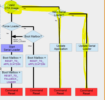

Unfortunately we cannot go in this direction. In our case we have many legacy products with various uC that use proprietary methods (i.e. pc and mobile applications) to store application images in SPI FLASH. In this case the bootloader needs to transfer an image from a 2nd FlexSPI FLASH to the first one and jump to the application. We cannot support a kboot type interface to load an application image into FLASH without a lot of changes in these applications. In this case the product will support firmware updates over Bluetooth and USB.

mjbcswitzerland
Specialist V
If I understand correctly you don't need a serial loader but a boot loader that support OTA transfers to an intermediate storage location in SPi flash.
That is, just the part in the flow diagram shown below.
The loader supports this for updating the application (copying from an area in the same SPI flash or a different SPI flash on FlexSPI or LPSPI) or updating the loader itself. Typically new images are transferred over Ethernet, Bluetooth, 4G modem, RF links, etc. whereby it is the application that actually performs the transfer/save and then the loader that subsequently handles fail-safe uploading and security.
This is also explained in https://www.utasker.com/docs/uTasker/uTasker_BM_Loader.pdf which has been used since 2005 on Coldfires, Kinetis (and various others) and now i.MX RT.
Plus a guide to using the serial loader to update itself if needed: https://www.utasker.com/docs/uTasker/uTaskerSerialLoaderUpdater.pdf using the OTA method.
There is in addition a video explaining the basic OTA part (on a Kinetis) https://www.youtube.com/watch?v=lm3M-ZlaFLQ&list=PLWKlVb_MqDQFZAulrUywU30v869JBYi9Q&index=17 and how its operation can be simulated to check all settings.

audio_guy
I already have a bootloader as in the highlighted diagram above that works with unencrypted code. I want to add encrypted XIP support. I had planned to add support for this using BEE by using the jump_to_application() function of AN12604SW. I need the "image_generate.exe" to prepare the image. Apparently uTasker has similar tools to prepare an image for use by your Bare-Minimum Loader.
