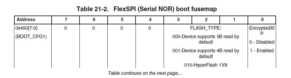

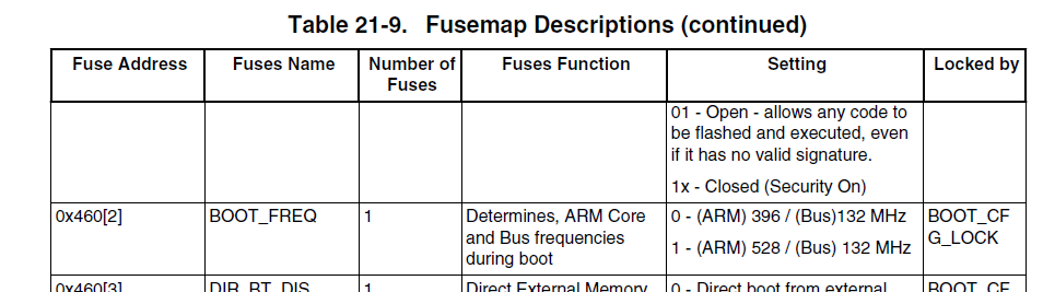

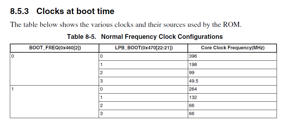

this table shows different core clock frequencies for different fuse settings
so BOOT_FREQ is setting CORE to 396 MHz or 528 MHz and the Bus frequency always to 132 MHz.

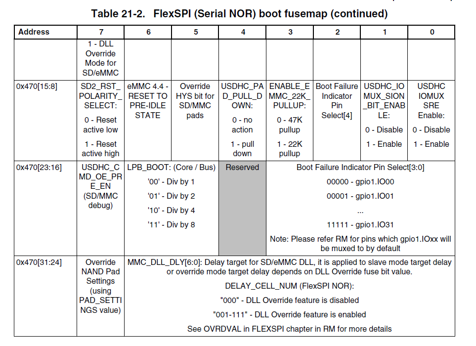

Then there are the divider LPB_BOOT fuses
My questions are:
  • Is there somewhere a table for RT1020 which specifies which fuses are burned by default and which are not? I want to know which clock frequencies the Boot ROM is setting.
  • Does LPB_BOOT divide core and bus, only the core frequency or does it set the divider from core clock to bus clock (e.g. 132 MHz bus clock is not possible for 396 MHz core clock because that would need LPB_BOOT div by 3)?
  • Does bus clock mean ipg_clk_root?
  • Which clock source will be used for the first start after power was removed e.g. will it use the external 24 MHz XTAL from the beginning or will it use the internal RC oscillator and switch to XTAL as soon as the XTAL is stable? I can't find information about that in the reference manual.

1) Is there somewhere a table for RT1020 which specifies which fuses are burned by default and which are not? I want to know which clock frequencies the Boot ROM is setting.
-- The default value of 0x460~0x470 area is 0.

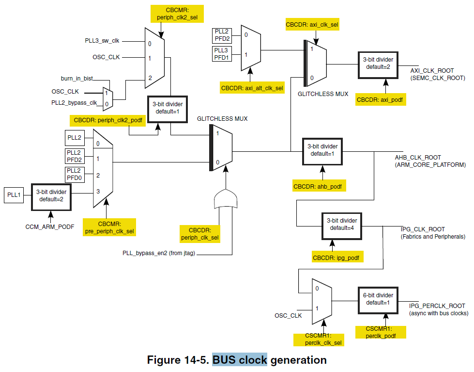

2) Does the bus clock mean ipg_clk_root?
-- No, I don't think so, as the below figure shows.
3) Which clock source will be used for the first start after power was removed e.g. will it use the external 24 MHz XTAL from the beginning or will it use the internal RC oscillator and switch to XTAL as soon as the XTAL is stable? I can't find information about that in the reference manual.
-- I'm not very clear with the question, in my opinion, the MCU won't run yet without the power supplies.
TIC

2) The picture shows a lot of dividers. Which of these dividers will be affected by the LPB_BOOT fuses?
3) I mean after I connect my board to a power supply, which clock, and at which frequency, will be used to start executing BOOT ROM code? Because I think that the BOOT ROM code will evaluate the boot clock fuses and set the clock system according to it.  Will the core boot with an internal RC oscillator or will it use the external XTAL (24 MHz or 32 kHz). If it uses the external XTAL how does it make sure that the XTAL oscillator is up and running stable?
Kind regards,
Stefan
6,791 Views
jeremyzhou
Hi Stefan Mitterhauser,
Thanks for your reply.
1) The picture shows a lot of dividers. Which of these dividers will be affected by the LPB_BOOT fuses?
-- Actually, we don't know.
2) In my opinion, the MCU would boot up with internal RC oscillator: 40 MHz.
TIC

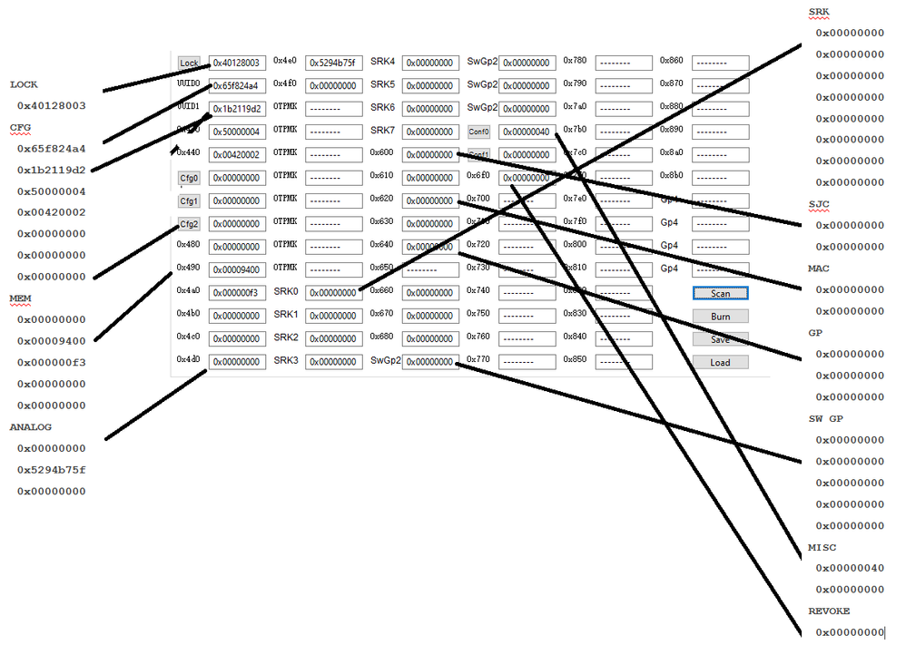

mjbcswitzerland
Specialist V
Stefan
Don't forget that the ROM LOADER will be setting things up and in case of double it is best to set a break point on entry into your code and look at register values so that you can see exactly which settings are used.

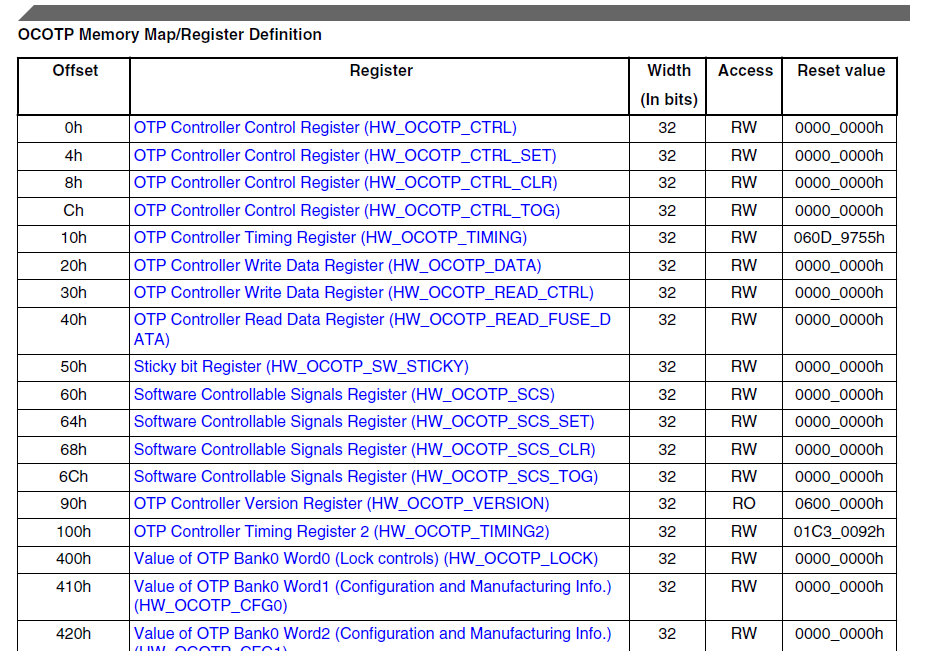

You can also read the eFUSE settings from their shadow registers in the OCOTP controller. This is what I read (from a command in the code) on an i.MX RT 1021 which hasn't had any fuse settings changed)
eFUSEs
LOCK
 0x40128003
CFG
 0x65f824a4

You can also read the eFUSE values with the NXP MCU Boot Utility tool.
Mark
[uTasker project developer for Kinetis and i.MX RT]

Senior Contributor I
Hello Mark,
thank you for sharing your results!
How do the values read from the shadow registers correlate with the fusemap? Is the offset shown in the ocotp memory map:
the address row of the fuse map?
Kind regards,
Stefan
6,791 Views
mjbcswitzerland
Specialist V
Stefan
The register offsets are the same as the eFUSE offsets (note that pastedImage_1.pngBeware: I updated the output in my previous post because I had made a mistake there.
Mark

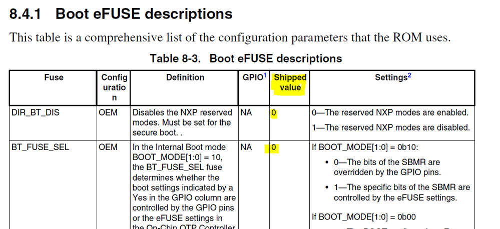

mjbcswitzerland
Specialist V
Stefan
eFUSES are almost all 0 in the shipped state. See section 8.4.1. for a table with the shied state:
Any eFUSEs shipped in '1' state cannot be changed since burning a fuse (setting to '1') is not reversible.
Mark
6,791 Views
imxrtuser
Hello Mark,
thank you again! You are right that table shows most of the eFuses for Boot (e.g. BOOT_FREQ is missing but this one can not be blown because that would configure the core at a frequency which not all derivates are specified for).
As you mentioned and asked in another question the state '1' cannot be changed so most of the eFuses will be not blown by default or the customer would not be able to change the settings. I still think that a table which shows the default for every eFuse in the fusemap (not for all are the shipped values shown) or a sentence like "every fuse listed here is not blown when shipped" would be nice to have so that I can be sure that the setting is correct for our use case without having to read back every fuse needed and check the value.
