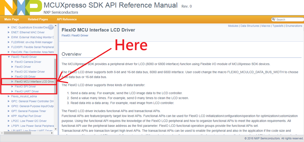

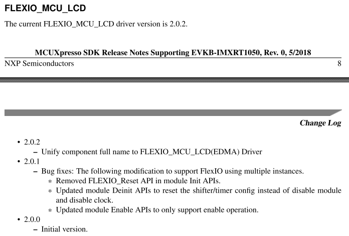

yi-yuanting
Hi Carlos_Musich,
Thanks for your reply. The information for RT1050 FlexIO driver for LCD 8080 is everywhere. You can easily found it by key word searching. For example:
(1) In SDK reference manual (MCUXSDKIMXRT1050APIRM), here it is :
(2) In SDK release note (MCUXSDKMIMXRT105XRN), here it is:
(3) In SDK on-line reference manual, here it is:
So, there must be driver files: "fsl_flexio_mculcd.c" & "fsl_flexio_mculcd.h" in Rt1050 SDK, but actually there's no such files in RT1050 SDK. (Now the newest version 2.4.2 doesn't contain that drivers, either.)
