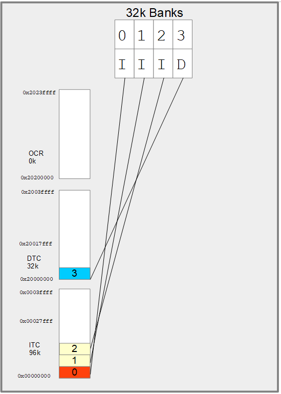

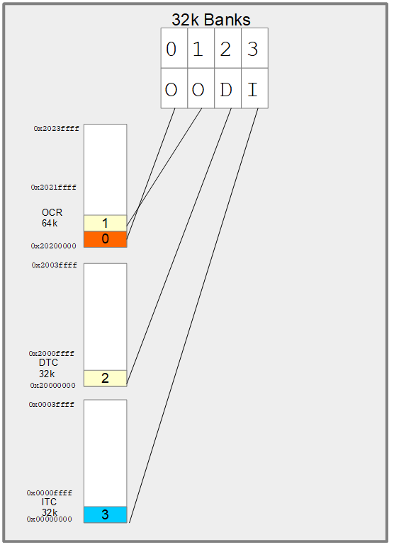

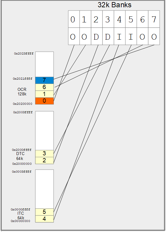

I have been using exclusively ITC and DTC (OCRAM disabled) by dynamically configuring the the FlexRAM at board initialisation and can confirm that it operates as expected (at the bottom are the shifts from default eFuse settings on i.MX RT 1011 and i.MX RT 1021 (128k and 256k examples) which also allow shuffling the banks and "retaining stack data", which allows doing fairly easily it in nested sub-routines using stack located variables.

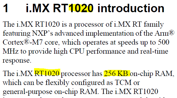

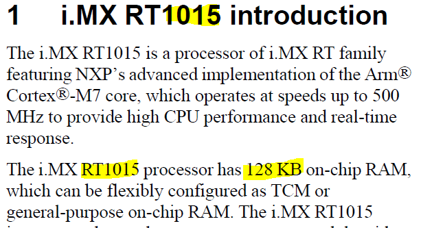

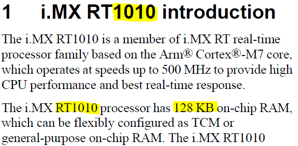

The only really weird thing that I found during the work was when I did it only an i.MX RT 1015, which should have 128k RAM like the 1011. I found it in fact has 256k RAM and 8 banks (just like the 1021) so had to reconfigure like the 1021 to get it working...
The data sheets:
pastedImage_2.png[this is either wrong or my chip is an exception...]
i.MX RT 1011 default memory (default eFuse setting)
Reconfigured for ITM/DTM use:
i.MX RT 1011 default memory (default eFuse setting) [and i.MX RT 1015!!!!]
