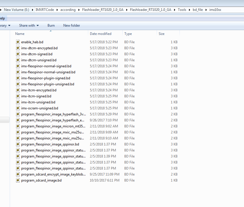

In the release package for the RT1020, in the folder:
Flashloader_RT1020_1.0_GA/Tools/bd_file/imx10xx
there are various .bd files.
Some of these are for creating a bootable image that is either unsigned, signed or encrypted.

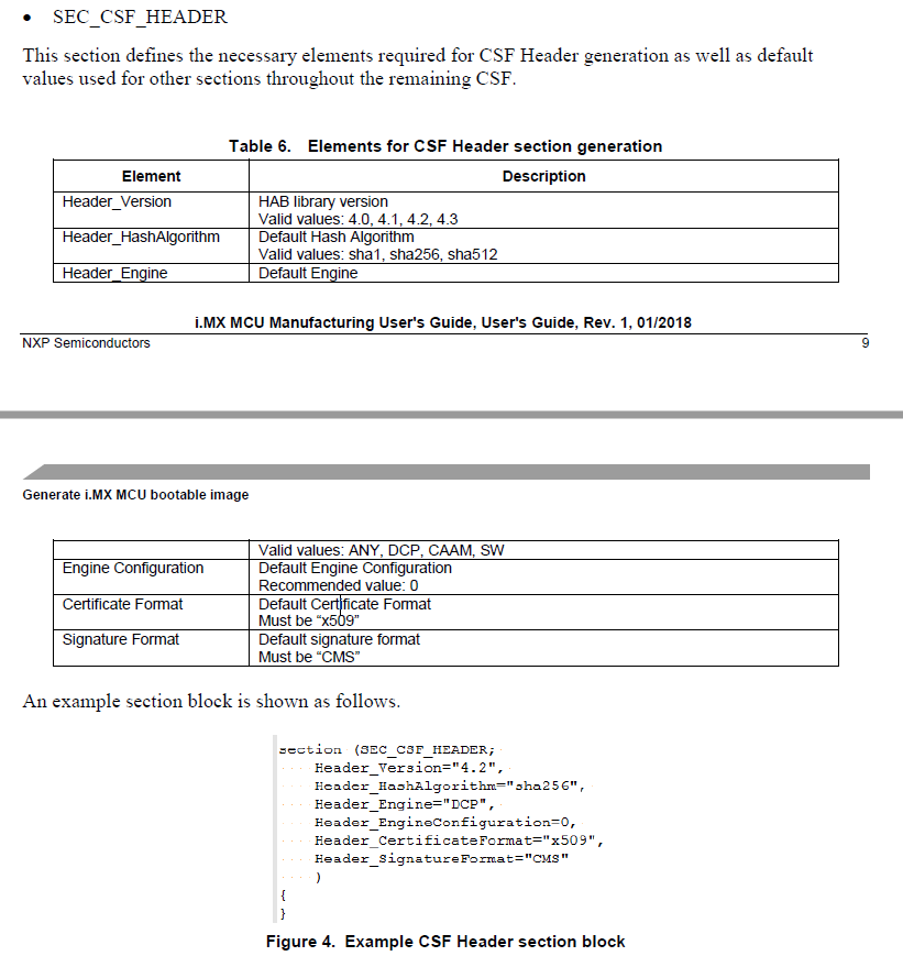

Hi rshipman ,
    Please read these document at first, I think you will be more clear about it:
1. RT1020 flashloader:
https://www.nxp.com/webapp/Download?colCode=Flashloader_RT1020_1.0_GA&appType=license
i.MX MCU Manufacturing User's Guide.pdf located in folder:
Flashloader_RT1020_1.0_GA\doc
You will find these information:
the version is the HAB library version.
2.Security Application Note AN12079
  From this AN, you will find signed is using the 4.2. 4.3 is the encrypted mode.

Answer: You can refer to the AN12079 to do the detail settings. The flashloader also give the different bd file, you can read it, it will be more clear:
Flashloader_RT1020_1.0_GA\Tools\bd_file\imx10xx
