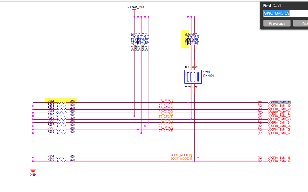

The Encrypt XIP dip switch SW8-1 is routed to GPIO_EMC_18 (on RT1020-EVK).
However the default iomux setting for that pin is ALT5 = GPIO2_IO18 of instance: gpio2
It is not ALT6 = SRC_BT_CFG00 of instance: src
So how does this dip switch work during boot, i.e. before software can re-route it?
Yet it does seem to work.

I had a look at the eval board schematic, and I can see (probably) how the different pull up/down resistors allow the SDRAM line to work if the SW8-1 switch is on. However I still do not understand how the GPIO_EMC_18 pin is routed to SRC_BT_CFG00, so that SW8-1 controls the Encrypt XIP settings. Is the ROM doing this?

    The MIMXRT1020-EVK is using the SW8_1 as the Encrypted XIP bit.
It use the pull up and the pull low to select the specifc Encrypted XIP bit data.
About your consideration about the pin function, you are right, during boot, the ROM bootloader will configure the related pin function.
