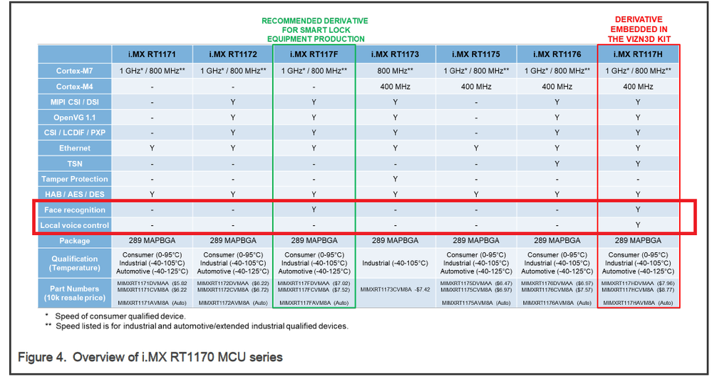

In SLN-VIZN3D-IOT-HDG.pdf, the followings are listed :
NXP 3D and 2D face-recognition solutions are supported by 2 i.MX RT1170 derivatives (i.MX RT117H and i.MX RT117H), which are also compatible with NXP future local-voice-control solutions. Both ICs have identical hardware characteristics and only differ in their software support. To help with customer evaluations, we mounted the superset i.MX RT117H silicon on the SLN-VIZN3D-IOT kit, but customers looking for face recognition should only consider the more economical i.MX RT117H version for their production.
And I attached the document about 'Overview of i.MX RT1170 MCU series.png'. For face recognition, it looks like that I must use i.MX RT117H.
Which device do I have to use for face recognition? i.MX RT117H or i.MXRT1176?
Please let me know that.
Thank you!

1) Of the i.MXRT1170 series, only the i.MXRT117H has a special function for face recognition?
-- Either i. MX RT117F or i.MX RT117H supports face recognition, you can learn it from the datasheet.

I checked the attached datasheet, but I couldn't find out the difference between MIMXRT1176DVMAA and MIMXRT117HDVMAA. In the datasheet, there is only 'Part number nomenclature', and it shows that the part 'H' must be used for hybrid solution with vision & voice. There is no explanation about the difference.
Is there no feature for vision & voice in MIMXRT1176DVMAA? In other words, Can I implement the vision & voice function in MIMXRT1176DVMAA?
I'm very confused because I can't understand how MIMXRT117H is different with MIMXRT1176.
Can you explain the difference in system block diagram of MIMXRT1170?
Best regards.
11,477 次查看
jeremyzhou
Thanks for your reply.
1) Is there no feature for vision & voice in MIMXRT1176DVMAA?
-- Yes. it doesn't support.
2) Can you explain the difference in the system block diagram of MIMXRT1170?
-- In my opinion, the attached figure has already illustrated the differences, for instance, the i.MX RT117H and i.MXRT1176 are the same except for the i. MX RT117H is able to be authenticated to run the library for face voice recognition.
