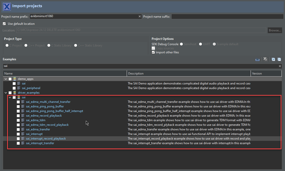

The recommendation is to use an external crystal for greater precision, but the specifications depend on your application's design. For PLL electrical characteristics, refer to chapter 4.2.3, "PLL’s Electrical Characteristics," in the datasheet. For XTAL considerations, see chapter 3.1, "Special Signal Considerations," in the datasheet.
With this in mind, you can use this external signal to provide the MCU clock and simultaneously use the MCU as a master to provide the MCLK for the DSP and codec.
For more information, refer to the Hardware Development Guide for the MIMXRT1050/MIMXRT1060 Processor or the design of the RT1060-EVKC. Additionally, the SDK (version 25.03) offers examples where the MCLK is generated in the MCU and provided to the codec:
I hope that helps.
