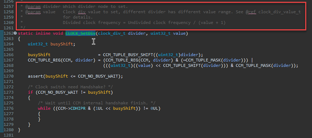

In the other hand, the reason for that comment may be because it is using the PLL4 as a clock source, where its frequency is 786.43 MHz, so in order to meet the maximum input frequency into the SAI mclk, pre-div must be at least 3.
The formula that is currently used to configure a pre divider value is the next: (value + 1). Following the example in the comment:
A pre-div value of 0x1 results in a pre-divider of: (1+1) = 2
This also is used in the SDK (version 2.16) function called "CLOCK_SetDiv", as shown the next image:

Do you, or anyone else, know what is meant by the SAI MCLK part of the following comment in the sai1 stanza nxp_rt10xx.dtsi in Zephyr ?
Especially in light of the limitations highlighted earlier in this thread.
/* The maximum input frequency into the SAI mclk input is 300MHz
 * Based on this requirement, pre-div must be at least 3
 * The pre-div and post-div are one less than the actual divide-by amount.
 * A pre-div value of 0x1 results in a pre-divider of
 * (1+1) = 2
