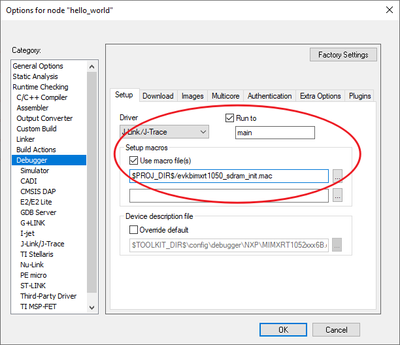

First, let's make sure that you are using the HelloWorld project from the official SDK right? Please do not modify any code or configuration. From your description, this issue is unlikely to happen.
Then, let's check if the configuration script for sdram_debug is missing, check this page:
Make sure that the configuration of this page is the same and that sdram_init.mac is indeed stored in the corresponding folder.

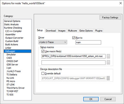

yes I'm using the example project from the official SDK and I created the project with MCUXpresso Config Tools.
The configuration window looks like yours:
and I can open the location with the three dots on the right side of the macro file and the file is there.
When I try to debug the project I get the following messages:
In the Debug Log window I can see the message "Wed Feb 28, 2024 13:19:41: Loaded macro file: C:...\hello_world1050evk/evkbimxrt1050/evkbimxrt1050_sdram_init.mac".
which also looks like it finds and uses the correct macro file.

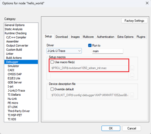

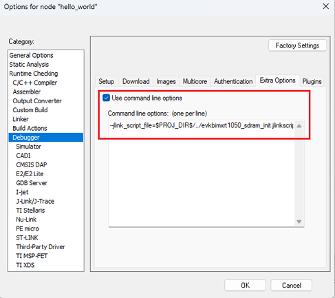

1.Uncheck "Use macro file", this is for DAP link
2.Check "Use command line options", and add below in box
--jlink_script_file=$PROJ_DIR$/../evkbimxrt1050_sdram_init.jlinkscript
Then everything should be ok.
