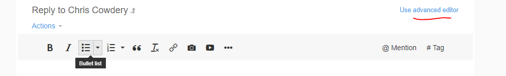

Hello Chris,
Hope you are doing well.
I'll be happy to check this from my end. When you hit the reply button you should see an option that says use advanced editor. So that you may attach the file to this post. Let me know if you are not able to so I can give you further instructions.
Sabina
3,746 Views
chriscowdery
Contributor V
Hi Sabina,
 I don't have 'Use advanced editor' :-( . Is there another way to send you an attachment?
Chris.
