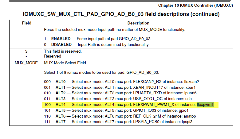

We have a hardware configuration that requires putting a PWM signal on the Flexpwm1 output X pin (GPIO_AD_B0_03).  I can get the SDK PWM example to put a PWM on A or B outputs, but not the X output.  I can't seem to make the PWM drivers access that pin for the pwm signal.  How do I configure the FlexPWM1 module, submodule 1 to do this?  Thanks.

Hi Peter Lombrozo,
   GPIO_AD_B0_03 can be used as flexpwm1.
Do you modify the pin_mux.c to configure the pin function?
If you already modify it, and it still can't work.
Please tell me the details about your modified code based on the SDK, then I will help you to check it.
Kerry
3,185 Views
peter_lombrozo
Yes, I had the pin mux correct.  The problem is that the PWM_X channel is not available in the SDK drivers.  However, I got it to work by modifying fsl_pwm.c,h to configure PWM_X that creates a new mode that was not aligned and disabling the deadband.
