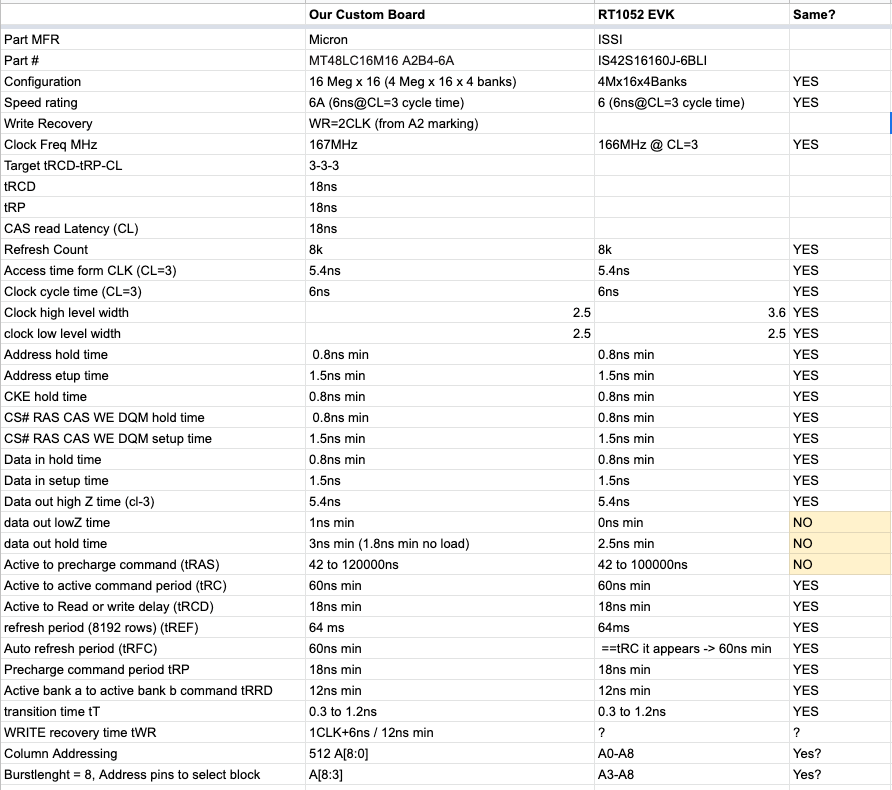

Could you confirm if the Micron MT48LC16M16A2b4-6a can use the same config as the RT1052EVK's ISSI is42s16160j-6bli SDRAM?
ISSI datasheet: http://www.issi.com/WW/pdf/42-45S83200J-16160J.pdf
Micron: https://www.micron.com/products/dram/sdram/part-catalog/mt48lc16m16a2b4-6a
They have the same memory / bank layout it appears... but:
I'm trying to test this Micron SDRAM on our board using the basic MCUXpresso SEMC demo:
SEMC_SDRAMReadWrite32Bit fails, but SEMC_SDRAMReadWrite16Bit and SEMC_SDRAMReadWrite8Bit both pass, so there's something specifically wrong w/ 32 bit writes/reads for us using the micron memory w/ the default EVK's SDRAM init.
Any thoughts on why just 32 bit would fail?

A quick comparison shows these two SDRAM parts should be identical for the config used in the SEMC demo app...
Any hints / ideas from SDRAM experts on what could be causing uint32_t access to fail while uint16_t and uint8_t are working fine?

This lines up with what i've found as well (see post below), but these are different from the evkbimxrt1050_semc demo.
If I simply make a project that runs the descriptor you provided, and then i do 0x1000 writes / reads (similar to the semc demo), it appears to work for uint32_t now (in addition to uinr16_t.
So I assume I should be using these timings now. For these, I have a few questions:
1. Can you help me understand why these descriptors enable all of the clocks? (i assume I should just be fine enabling the following in my code:
  CLOCK_EnableClock(s_semcClock[SEMC_GetInstance(base)]);
  CLOCK_EnableClock(s_semcExtClock[SEMC_GetInstance(base)]);
2. Why are the timings slightly different from the semc demo even for the same ISSI part?
3. Could you possibly enlighten me on which pins are required / used when doing 32bit accesses but not required for 16bit? Or are the same pins used and just timing is different between the access sizes?
-- In my opinion, the above two lines are enough to enable the clock of the SEMC module.
2. Why are the timings slightly different from the SEMC demo even for the same ISSI part?
-- The descriptors are used to generate the DCD bin file, definitely, it wouldn't be as same as the SEMC demo.
-- The pins connection is unnecessary to change to suit for different bit length read and write, however, in my opinion, the timing sequence would be a bit different.
