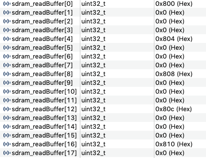

I'm trying to test this Micron SDRAM on our board using the basic MCUXpresso SEMC demo:
SEMC_SDRAMReadWrite32Bit fails, but SEMC_SDRAMReadWrite16Bit and SEMC_SDRAMReadWrite8Bit both pass, so there's something specifically wrong w/ 32 bit writes/reads for us using the micron memory w/ the default EVK's SDRAM init.
Any thoughts on why just 32 bit would fail?

I'm having the same issue on the Embedded Artists RT1062 board, 32 bit not working, 16/8 bit working.   No further resolution?
7,697 Views
variable_andrew
Senior Contributor I
A quick comparison shows these two SDRAM parts should be identical for the config used in the SEMC demo app...
Any hints / ideas from SDRAM experts on what could be causing uint32_t access to fail while uint16_t and uint8_t are working fine?

I'll add a note to this - so based on the tests, it seems that the controller manages reads/writes to SDRAM so long as the variable being read/written is uint8_t or uint16_t based, but fails for uint32_t.
What is needed to enable the SDRAM controller to manage this?

jeremyzhou
I've attached two descriptors of the MT48LC16M16A2B4-6A and IS42S16160J. They can help you to adjust initialization function code.
DCD Descriptor

variable_andrew
Actually - testing with the descriptors worked for me for a few times, but eventually 32 bit accesses begin to fail as well, giving read output like so (instead of 0, 1, 2, 3, 4, ...:
What I found was that if I don't set "Reset on Connect" in the LinkServer Debugger options - then 32 bit accesses work when I re-run the app, but if I do set "Reset on Connect", then 32 bit accesses fail...
Further testing shows that if I just write garbage to SDRAM, and then read back - then subsequent writes and reads work to areas that had previously been accessed (on the MT device)...
7,697 Views
