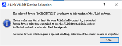

felix1
Hi Jay,
I try your RT-UFL and receive the following message.
