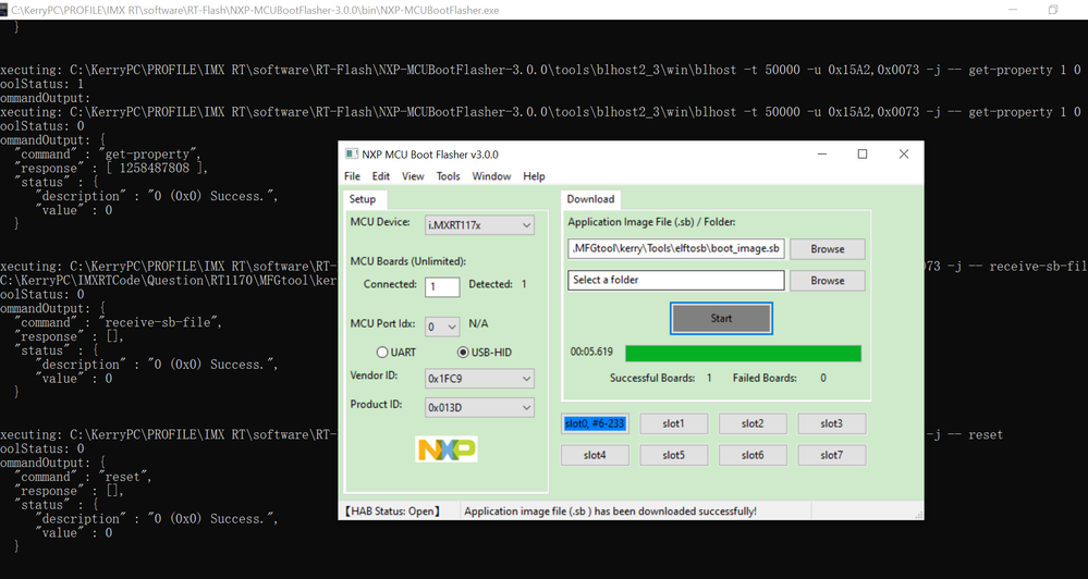

kerryzhou
Hi fmabrouk,
  Another good tool for your, still from the MCUBOOTUtility author, which is used to replace the MFGTool:
https://github.com/JayHeng/NXP-MCUBootFlasher/releases/tag/v3.0.0
Manual:
https://github.com/JayHeng/NXP-MCUBootFlasher/blob/master/README.md
My test result and I also attach my generated .sb for you.
This tool is also very easy to use, and I have test it, it works OK with my generated .sb file.
Kerry

Hi fmabrouk,
1. About the RT1170 download command, in fact, I already give you all the related command in the previous reply, just like the MCUBootUtility log, it use the blhos download the flashloader to the internal RAM at first, then run the flashloader, and configure the external memory and download the app directly.
Executing: C:\KerryPC\tool\NXP-MCUBootUtility-2.4.0\tools\blhost2_3\win\blhost -t 50000 -u 0x1FC9,0x013D -j -- get-property 1 0
toolStatus: 0
commandOutput: {
"command" : "get-property",
"response" : [ 1258487809 ],
"status" : {
"description" : "0 (0x0) Success.",
"value" : 0
Executing: C:\KerryPC\tool\NXP-MCUBootUtility-2.4.0\tools\blhost2_3\win\blhost -t 50000 -u 0x1FC9,0x013D -j -- get-property 17 0
toolStatus: 0
commandOutput: {
"response" : [ 0 ],
"status" : {
"value" : 0
Executing: C:\KerryPC\tool\NXP-MCUBootUtility-2.4.0\tools\blhost2_3\win\blhost -t 5242000 -u 0x1FC9,0x013D -j -- load-image C:\KerryPC\tool\NXP-MCUBootUtility-2.4.0\src\targets\MIMXRT1176\ivt_flashloader.bin
toolStatus: 0
commandOutput: {
"command" : "load-image",
"response" : [],
"status" : {
"value" : 0
Executing: C:\KerryPC\tool\NXP-MCUBootUtility-2.4.0\tools\blhost2_3\win\blhost -t 50000 -u 0x15A2,0x0073 -j -- get-property 1 0
toolStatus: 0
commandOutput: {
"response" : [ 1258487808 ],
"status" : {
"value" : 0
toolStatus: 0
commandOutput: {
"status" : {
"value" : 0
Executing: C:\KerryPC\tool\NXP-MCUBootUtility-2.4.0\tools\blhost2_3\win\blhost -t 50000 -u 0x15A2,0x0073 -j -- get-property 24 0
toolStatus: 0
commandOutput: {
"response" : [ 1409351680 ],
"status" : {
"value" : 0
Executing: C:\KerryPC\tool\NXP-MCUBootUtility-2.4.0\tools\blhost2_3\win\blhost -t 50000 -u 0x15A2,0x0073 -j -- efuse-read-once 22
toolStatus: 0
commandOutput: {
"command" : "efuse-read-once",
"response" : [ 4, 0 ],
"status" : {
"value" : 0
Executing: C:\KerryPC\tool\NXP-MCUBootUtility-2.4.0\tools\blhost2_3\win\blhost -t 5242000 -u 0x15A2,0x0073 -j -- read-memory 1074675776 4 C:\KerryPC\tool\NXP-MCUBootUtility-2.4.0\tools\blhost2_3\win\vectors\readReg.dat 0
toolStatus: 0
commandOutput: {
"command" : "read-memory",
"response" : [ 0 ],
"status" : {
"description" : "10200 (0x27D8) kStatusMemoryRangeInvalid",
"value" : 10200
Executing: C:\KerryPC\tool\NXP-MCUBootUtility-2.4.0\tools\blhost2_3\win\blhost -t 5242000 -u 0x15A2,0x0073 -j -- fill-memory 538976256 4 3482320897 word
toolStatus: 0
commandOutput: {
"command" : "fill-memory",
"response" : [],
"status" : {
"value" : 0
Executing: C:\KerryPC\tool\NXP-MCUBootUtility-2.4.0\tools\blhost2_3\win\blhost -t 50000 -u 0x15A2,0x0073 -j -- configure-memory 9 538976256
toolStatus: 0
commandOutput: {
"command" : "configure-memory",
"response" : [],
"status" : {
"value" : 0
Executing: C:\KerryPC\tool\NXP-MCUBootUtility-2.4.0\tools\blhost2_3\win\blhost -t 5242000 -u 0x15A2,0x0073 -j -- fill-memory 538976256 4 3221225479 word
toolStatus: 0
commandOutput: {
"response" : [],
"status" : {
"value" : 0
Executing: C:\KerryPC\tool\NXP-MCUBootUtility-2.4.0\tools\blhost2_3\win\blhost -t 5242000 -u 0x15A2,0x0073 -j -- fill-memory 538976260 4 0 word
toolStatus: 0
commandOutput: {
"response" : [],
"status" : {
"value" : 0
toolStatus: 0
commandOutput: {
"response" : [],
"status" : {
"value" : 0
Executing: C:\KerryPC\tool\NXP-MCUBootUtility-2.4.0\tools\blhost2_3\win\blhost -t 5242000 -u 0x15A2,0x0073 -j -- read-memory 805307392 1024 C:\KerryPC\tool\NXP-MCUBootUtility-2.4.0\tools\blhost2_3\win\vectors\flexspiNorCfg.dat 9
toolStatus: 0
commandOutput: {
"response" : [ 1024 ],
"status" : {
"value" : 0
C:\KerryPC\tool\NXP-MCUBootUtility-2.4.0\tools\elftosb4\win>"C:\KerryPC\tool\NXP-MCUBootUtility-2.4.0\tools\elftosb4\win\elftosb.exe" -f imx -V -c "C:\KerryPC\tool\NXP-MCUBootUtility-2.4.0\gen\bd_file\imx_application_gen.bd" -o "C:\KerryPC\tool\NXP-MCUBootUtility-2.4.0\gen\bootable_image\ivt_led_blinky_0x3000a000_unsigned.bin" "C:\KerryPC\tool\NXP-MCUBootUtility-2.4.0\apps\NXP_X-IMXRT1170-VAL_Rev.A2\cm7\led_blinky_0x3000a000.srec"
Section: 0x0
iMX bootable image generated successfully
Executing: C:\KerryPC\tool\NXP-MCUBootUtility-2.4.0\tools\blhost2_3\win\blhost -t 2048000 -u 0x15A2,0x0073 -j -- flash-erase-region 805306368 49152 9
toolStatus: 0
commandOutput: {
"command" : "flash-erase-region",
"response" : [],
"status" : {
"value" : 0
Executing: C:\KerryPC\tool\NXP-MCUBootUtility-2.4.0\tools\blhost2_3\win\blhost -t 5242000 -u 0x15A2,0x0073 -j -- fill-memory 538980352 4 4026531855 word
toolStatus: 0
commandOutput: {
"response" : [],
"status" : {
"value" : 0
Executing: C:\KerryPC\tool\NXP-MCUBootUtility-2.4.0\tools\blhost2_3\win\blhost -t 50000 -u 0x15A2,0x0073 -j -- configure-memory 9 538980352
toolStatus: 0
commandOutput: {
"response" : [],
"status" : {
"value" : 0
Executing: C:\KerryPC\tool\NXP-MCUBootUtility-2.4.0\tools\blhost2_3\win\blhost -t 5242000 -u 0x15A2,0x0073 -j -- write-memory 805310464 C:\KerryPC\tool\NXP-MCUBootUtility-2.4.0\gen\bootable_image\ivt_led_blinky_0x3000a000_unsigned_nopadding.bin 9
toolStatus: 0
commandOutput: {
"command" : "write-memory",
"response" : [],
"status" : {
"value" : 0
Executing: C:\KerryPC\tool\NXP-MCUBootUtility-2.4.0\tools\blhost2_3\win\blhost -t 5242000 -u 0x15A2,0x0073 -j -- read-memory 805306368 46154 C:\KerryPC\tool\NXP-MCUBootUtility-2.4.0\tools\blhost2_3\win\vectors\bootableImageFromBootDevice.dat 9
toolStatus: 0
commandOutput: {
"response" : [ 46154 ],
"status" : {
"value" : 0
Executing: C:\KerryPC\tool\NXP-MCUBootUtility-2.4.0\tools\blhost2_3\win\blhost -t 50000 -u 0x15A2,0x0073 -j -- reset
toolStatus: 0
commandOutput: {
"command" : "reset",
"response" : [],
"status" : {
"value" : 0
2. About the secure RT1060, do you already sign the NDA with NXP side?
All the related communication, I suggest you go to the nxp website, and create the case:
1). Open below SUPPORT site, click blue "Go to Tickets" in the middle.
http://www.nxp.com/support/support:SUPPORTHOME
2).Then you will be requested to Login, if you have no an account, please first Register with your business email.
3).After login, please "Create New Cases" button in the middle, then you can submit your question.
Wish it helps you!
Kerry
