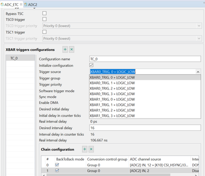

I'm trying to configure ADC_ETC to start conversions on ADC2. With help from Config Tool, IO have set up two conversion chains. One using ADC1 and one using ADC2.
The one using ADC1 works perfectly.
The one using ADC2 are using the channels configured for ADC1.
I'm using SW triggers.
In the Config Tool I cannot see any effect by changing the "Trigger source". The reference manual says that to use ADC2 you have to use "trig4~trig7", but the Config Tool only shows "XBARx_TRIG 0-3". Is XBAR1, TRIG 0-3 the same as trig4~trig7? Using this still uses the configuration from ADC1.

jingpan
Hi kl,
Yes, ADC_ETC_TRIG00 ... ADC_ETC_TRIG13 corresponding to trg0 ... trg7, see the NOTE in XBAR resource Assignments in reference manual.  But yes, the name seems not match in Config Tool window. There isn't anything called XBAR0 in RM.

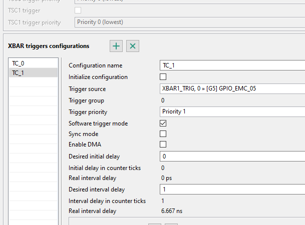

kl
Hi Jing
I just tried to change the trigger source for the trigger chain. It seems that the change does not reflect into any code change. So the trigger source is probably not changed to any signal that triggers ADC2.
Therefore it triggers the trigger chain configured for ADC1 instead.
I only plan to use SW triggers, but I tried to configure the last spare pin as a trigger source for XBAR1_TRIG, 0, and configure my trigger chain 1 to use this as trigger:
But I cannot find any generated code that routes the trigger source to the trigger chain.
I have tried to find the ADC_ETC registers (in the RM) that maps the HW triggers to the trigger chains with no luck. I wander, is it fixed to the trigger chain number (also called "trigger group"? in the config tool, I'm confused)? So I have to use trigger chain 4-7 to trigger conversions on ADC2?

jingpan
Hi Kasper,
yes, you're right. It should use adc_etc_config_t.XBARtriggerMask to select trig source. But Config Tool only keep it as 1. I'll report this problem.
Please refer to adc_etc_hardware_trigger_conv demo.
Jing
