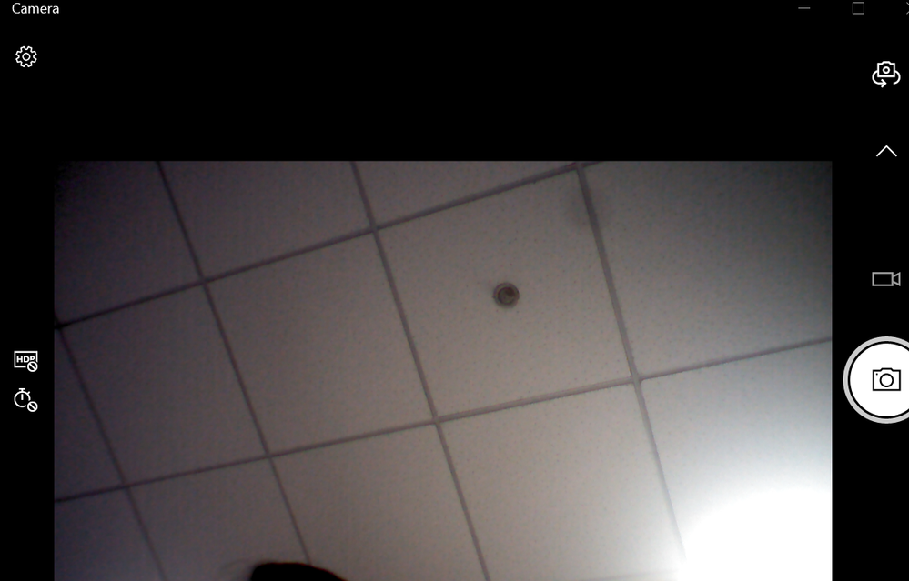

Hi All,
we are trying to interface the camera and the I2S mic in RT1060. RT1060 will enumerate as UVC and UAC USB class. I used the two different ISO endpoint for the UVC as well as UAC. While we trying to stream the UVC and UAC separately we are able to get the proper video and audio data without any issues. While we trying to stream both the camera and i2s mic then we are getting noise is audio data which means through ISO transfer audio data is not sending properly.  Both the data are sent using the api "USB_DeviceSendRequest". What may be root cause for this issue?

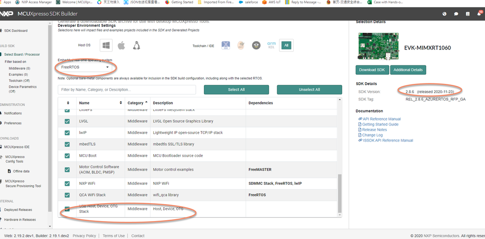

kerryzhou
Seems I can't add the other pictures in the above post, just add another freertos version picture:

2) If we go for an RTOS, which RTOS should be use for USB either Amazon FreeRTOS or Azure RTOS?. In latest SDK we don't find any USB related Amazon free RTOS.  Do we have any RTOS source code which streams the MT9M114 sensor in UVC?
Answer: in fact, you can use the FreeRtos.
You just need to download the newest SDK version in the rtos mode, then you will find the usb_device_video_virtual_camera related freertos version.
SDK_2.8.6_EVK-MIMXRT1060_freertos\boards\evkmimxrt1060\usb_examples\usb_device_video_virtual_camera\freertos

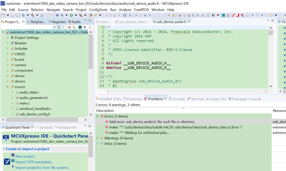

Now I can download the code to my board, your project has one build error, seems caused by the header file path missing,
after I add the path, it builds without any issues, and can download the code now.

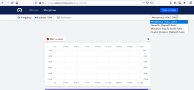

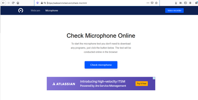

Sorry, you can test the mic in your side also. Since we sending the static audio data.
To test the audio, please go the below website,
https://webcammictest.com/check-mic.html
Click on the Check microphone option. 
Then select the audio device "VIDEO DEMO". If you playing the audio data alone without streaming the camera means, you will hear the audio sound. While you streaming the both camera and audio data means the audio sound will differ where during camera streaming audio data is not sent because of this we will get that sound differently.
