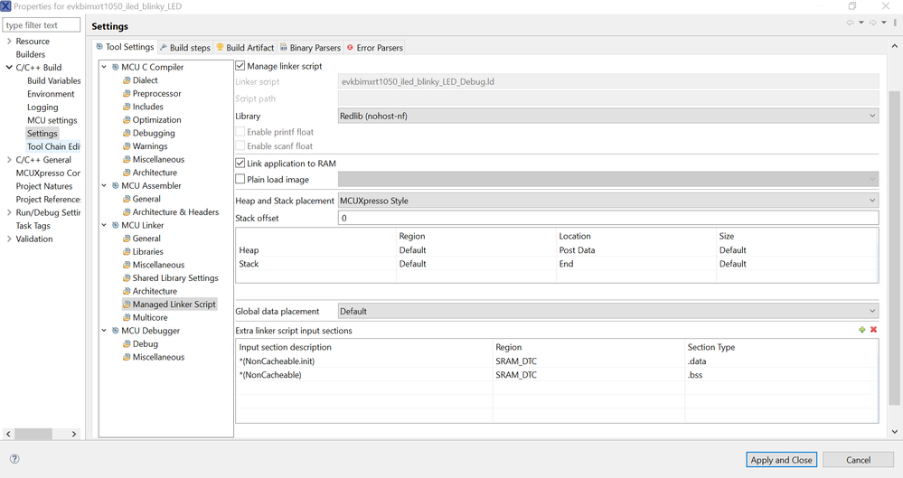

I'm creating an instruction manual for the i.MX RT 1050 EVK for hobbyists. It is a work in progress and can be downloaded from Dropbox here
In the manual I show how to execute from SRAM. It is very straightforward - simply check the "Link application to RAM" box:
This places code in "SRAM_DTC", as this memory is in the first row of the table in the "MCU settings" window. I am able to upload and debug without any problems.

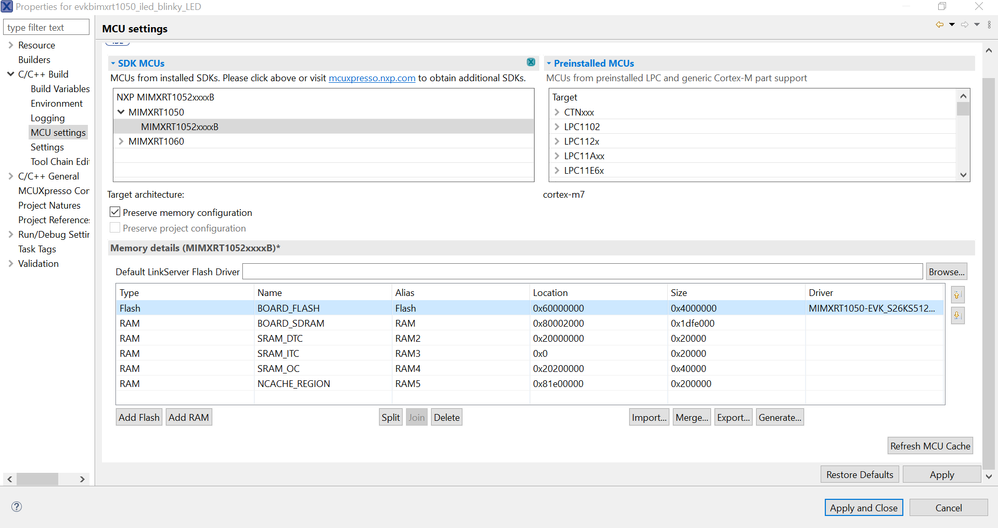

Now I'm trying to upload to and execute from SDRAM. This is more complicated, and some of the suggestions I've tried without success include:
1) Move "BOARD_SDRAM" to the second row of the table
2) Change the location and size of the "BOARD_SDRAM" memory
3) Modify the Preprocessor
Below are my settings and the error message generated when I try to start a debug session:

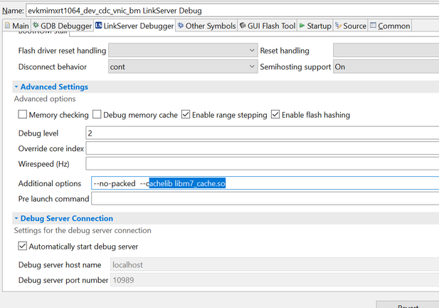

Hi @danielmilutinov ,
Yes, this is due to the cache issue. Before debug in SDRAM, you should add --cachelib libm7_cache.so to Additional options.

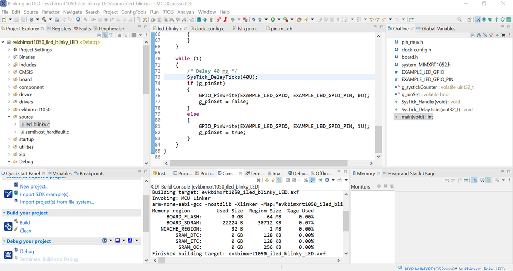

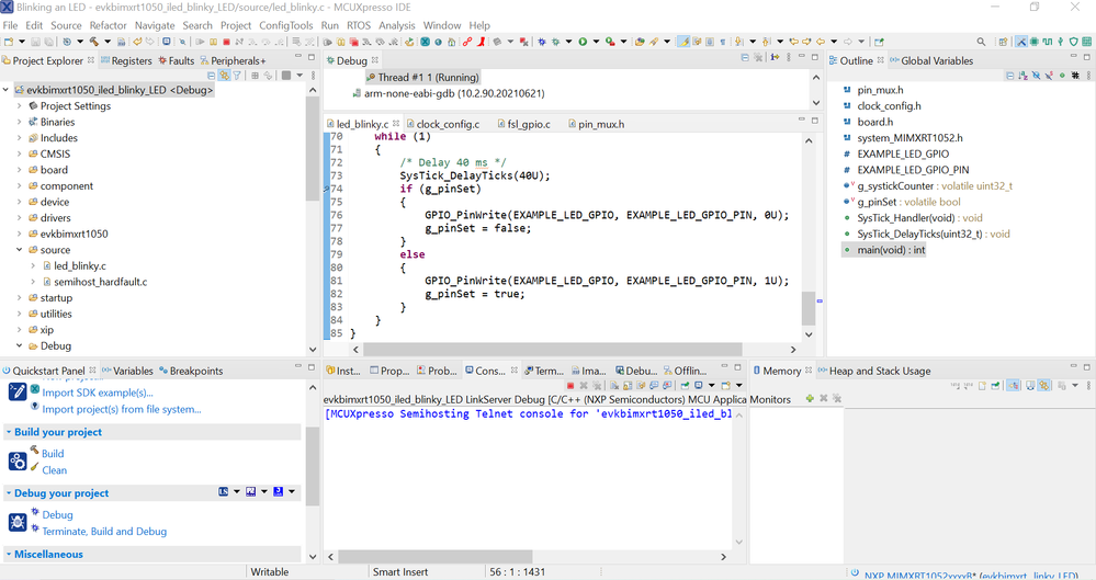

I can now upload to and execute from SDRAM. However breakpoints don't work during a debug session - any breakpoints that I set are ignored and the program runs as if there are no breakpoints.

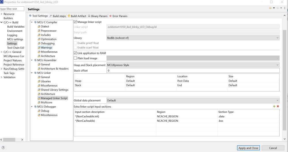

I was able to upload to and execute from SDRAM by making the following changes:
1) Move "NCACHE_REGION" up in the table:
2) Add "DATA_SECTION_IS_CACHEABLE=1" to the Preprocessor:
3) Change "SRAM_DTC" to "NCACHE_REGION" in "Managed Linker Script":
As mentioned, I can now upload to and execute from SDRAM the "iled_blinky" example from "demo_apps", but any breakpoints set during a debug session have no effect:

danielmilutinov
Thank you Jing, that works nicely. After adding  "--cachelib libm7_cache.so" in the "Additional options" field I debug by pressing the green bug icon in the toolbar and everything works well (debugging by pressing "Debug" in the "Quickstart Panel" View did not work for me).
