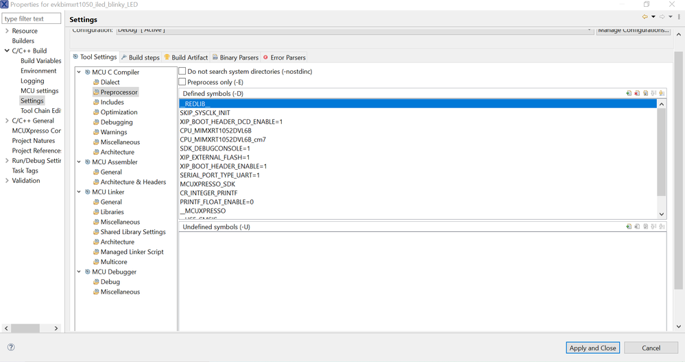

Now I'm trying to upload to and execute from SDRAM. This is more complicated, and some of the suggestions I've tried without success include:
1) Move "BOARD_SDRAM" to the second row of the table
2) Change the location and size of the "BOARD_SDRAM" memory
3) Modify the Preprocessor

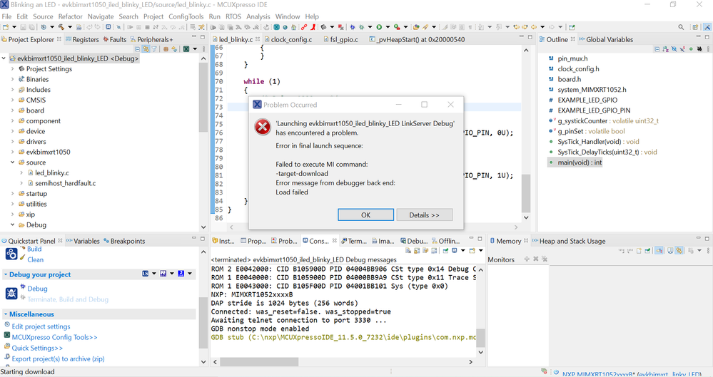

Below are my settings and the error message generated when I try to start a debug session:
The Console View contains the following message:

GDB stub (C:\nxp\MCUXpressoIDE_11.5.0_7232\ide\plugins\com.nxp.mcuxpresso.tools.bin.win32_11.5.0.202112161150\binaries\crt_emu_cm_redlink) terminating - GDB protocol problem: Pipe has been closed by GDB.

Hi @danielmilutinov ,
Yes, this is due to the cache issue. Before debug in SDRAM, you should add --cachelib libm7_cache.so to Additional options.

I can now upload to and execute from SDRAM. However breakpoints don't work during a debug session - any breakpoints that I set are ignored and the program runs as if there are no breakpoints.
I was able to upload to and execute from SDRAM by making the following changes:
1) Move "NCACHE_REGION" up in the table:
2) Add "DATA_SECTION_IS_CACHEABLE=1" to the Preprocessor:
3) Change "SRAM_DTC" to "NCACHE_REGION" in "Managed Linker Script":
As mentioned, I can now upload to and execute from SDRAM the "iled_blinky" example from "demo_apps", but any breakpoints set during a debug session have no effect:
