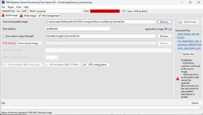

Hi, I've been trying to write an image into my board but I'm not able to.
I've tried various configurations but I always end up in an error.
I'm currently using MCUXpresso Secure Provisioning Tool v8.0, I'm connected via UART, I'm using a imxrt1060, my flash memory is a W25Q512JV.

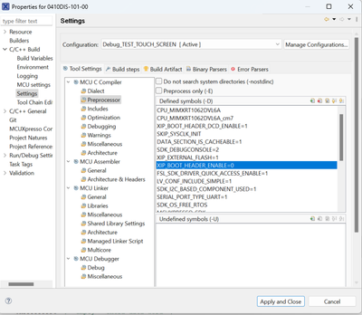

I've read that it is suggested to offset the flash location from 0x60000000 to 0x60002000
And to set XIP_BOOT_HEADER_ENABLE as 0
But this way SPT (secure provisioning tool) doesn't get automatically the FCB configuration and the DCD.
This means that I have to manually configure the boot memory type, but mine is not one of the Predefined Templates and I can't figure out a configuration that passes the test, always ending up in "FlexSPINOR: SFPD Not Found"
Meanwhile, keeping the memory address as 0x60000000 and XIP_BOOT_HEADER_ENABLE as 1 I'm able to successfully build an image, but, when I try to write the image, I get the error "20106 FlexSPINOR: Command Failure"

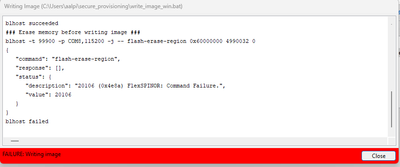

Alessandro_Alpi
Hi @kerryzhou,
The flexSPI_nor_polling demo works as intended now (loaded via MCU-link debug probe).
But even after matching its LUT the problem still remains:
>blhost.exe -p COM8,115200 -- flash-erase-region 0x60000000 4989372 0
Ping responded in 1 attempt(s)
Inject command 'flash-erase-region'
Response status = 20106 (0x4e8a) kStatus_FlexSPINOR_CommandFailure.
Write operations work fine, flash-erase-region seems to be the only problem.
I've noticed that the datasheet talks about sector and block erase rather then region erase but I don't know if it's relevant.
About the DQS pin issue, I set it up like this:
But it still gives me the same error.
May it be a flashloader issue of some kind? Maybe it gets generated wrong for some reason.
Maybe I should replace the instruction bytes with their "4-byte address" equivalent?
If anything comes to mind please let me know.

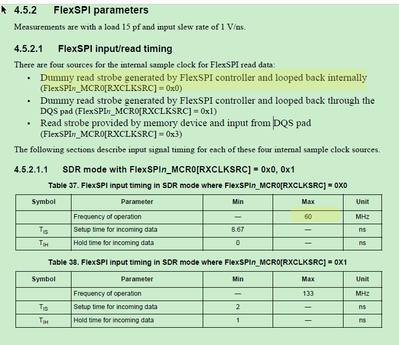

kerryzhou
Hi @Alessandro_Alpi ,
 Yes, if your DQS pin is not floating, you need to set the flexSPI frequency to 60Mhz:
And Dummy read strobe generated by FlexSPI controller and looped back internally
(FlexSPIn_MCR0[RXCLKSRC] = 0x0).
You can try the 60Mhz in Secure Provisioning Tool at first, whether you can finish the connecting and code downloading.
If you still have issues about it, please kindly let me know.
