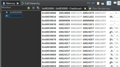

using imx rt 1024, for my position independent code experiment I am trying to debug my "offsetted" application, but gdb isn't loading the symbols.
What am I doing wrong?
For background:
- my bootloader sits at 0x60000000
- app1 (not uploaded) normally sits at 0x60020000
- app2 is uploaded with above offsets of 0x10000
When I debug the app with above configuration, when I press suspend debugger I can analyze the memory. I can see that my app is properly uploaded to 0x6003000. But the debugger (gdb) is not able to locate the symbols
(memory shows my app is in memory on desired offset location)
PS: vector table and .got are both in sram. in my startup code I properly patch the ISR vector addresses, so that's not the problem. When I put a breakpoint in the first line of my ResetHandler, it doesn't hit. When I pause my application once started, it can't find symbols.
Many thanks!

Managed to get it working after all. Using gdb command `add-symbol-file <path-to-elf> <address-to-text-section> just before I jump from my bootloader to the relocated app fixed it.
Well, to be fair, I didn't test it in MCUxresso, I migrated my projects to VScode instead (compiling with CMake). But I am sure it works all the same in MCUxpresso
