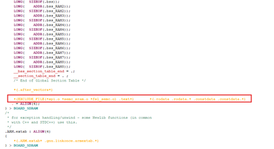

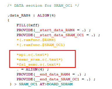

Actually i was trying to run the SRAM related files in SRAM instead of running in SDRAM for below changes in linker file marked in red box below.
change 1:
change 2:
Similarly please help me run SRAM related files in FLASH instead of SRAM in linker file as shown above.

It seems you want to run some code which was related to SRAM in Flash, I am not sure if below comments help you.
// data.ldt for reference.
MEMORY
    SRAM_ITC (rwx) : ORIGIN = 0x20200000, LENGTH = 0x40000
SECTIONS
    .text.sram_init :
        *spi.o(.text)
        *semc_sram.o(.text)
        *fsl_semc.o(.text)
    } > FLASH
    .rodata.sram_init :
        *spi.o(.rodata)
        *semc_sram.o(.rodata)
        *fsl_semc.o(.rodata)
    } > FLASH
// main_text.ldt for reference.
MEMORY
    FLASH (rx) : ORIGIN = 0x60000000, LENGTH = 0x800000 /* Adjust as per your flash size */
    SRAM_OC (rwx) : ORIGIN = 0x20000000, LENGTH = 0x20000
    SDRAM (rwx) : ORIGIN = 0x80000000, LENGTH = 0x800000 /* Adjust as per your SDRAM size */
SECTIONS
    .text :
        *(EXCLUDE_FILE(*spi.o *semc_sram.o *fsl_semc.o) .text)
    } > FLASH
    .text.sram_init :
        *spi.o(.text)
        *semc_sram.o(.text)
        *fsl_semc.o(.text)
    } > FLASH
    .rodata :
        *(EXCLUDE_FILE(*spi.o *semc_sram.o *fsl_semc.o) .rodata)
    } > FLASH
    .rodata.sram_init :
        *spi.o(.rodata)
    } > FLASH
