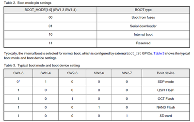

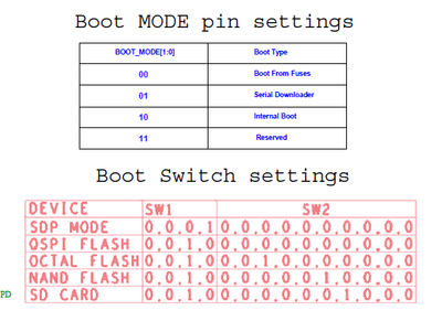

Hi team,
We are using imxrt1170 eval board and we are trying to boot from the NAND flash as per the Dip switch setting shown in the IMXRT hardware user guide document "MIMXRT1170 EVK Board Hardware User’s
Guide".
But we are facing the below mentioned error in the MCUxpresso tool when we are debugging and flashing the code on the eval board. Please suggest the steps to resolve this issue and boot the code from the NAND flash.

santhoshkumar_T
Hi @kerryzhou ,
We have tried NAND flash sdk example it was working fine.
And we have changed the switch setting too.

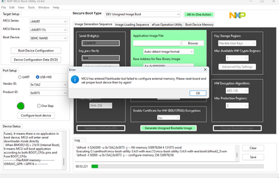

Below are the steps i have followed.
Step1:
SW1:1-OFF 2-OFF 3-OFF 4-ON ----> To enter serial mode.
SW2: 6th bit ON---> To boot from flash.
Step2:
Tried to connect from the NXP Boot utility.
It was connected to ROM but failed to connect to NAND Flash.(By selecting SEMC NAND in selection prompt)
Same thing is working for SPI Nor flash(If i select SPI NOR in selection prompt). Able to erase and program Nor flash.
refer below image with error message for SEMC NAND

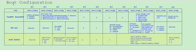

kerryzhou
Hi @santhoshkumar_T ,
 NandFlash boot need to use the non-xip app, and also need to configure the BOOT_CFG.
Please refer to this information:
non-xip app means you need to put your demo in the internal RAM.
You can refer to this document:
https://www.cnblogs.com/henjay724/p/12591382.html
Wish it helps you!
Kerry

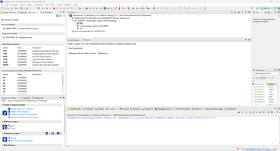

Jeevan
Hi @kerryzhou ,
We have soldered the resistors (R1872 to R1879) connected to the NAND flash.
But still its throwing error (data bus error) when we change the dip switch setting to NAND flash.
1,561 Views

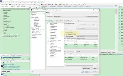

kerryzhou
Hi @Jeevan ,
 You can try to run the code in the internal RAM:
As I find your side is the code is not running.

Jeevan
Hi @kerryzhou ,
I have verified with QSPI flash, octal flash and serial downloader and all are working fine.
even i tried to run the code through SDRAM and internal RAM.
Only the NAND flash option is not working and i am not finding any driver for NAND flash in the listed options.
1,510 Views
kerryzhou
Hi @Jeevan ,
  Oh, I know your confusing point.
  Please note, the nand flash is not the XIP memory, so, you can't debug the code in the nand flash.
Normally, we generate the code, and use the tool to download code to the nand flash, and boot it from the nand flash.
  The tool, you can use the MCUBootutility or the SEC(mcuxpresso secure provisional tool):
1. https://github.com/JayHeng/NXP-MCUBootUtility/releases/tag/v6.1.0
the related user manual is:
2. mcuxpresso secure provisional
https://www.nxp.com/design/design-center/software/development-software/mcuxpresso-software-and-tools...
If you have any issues about the tool usage for the nandflash, you can help to create a new question post and let me know, we can discuss about the details in your new case, thanks.
