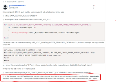

I tried to implement it by this way but it doesn't work (enumeration failed):
  • Setting SDRAM shareable
    MPU->RBAR = ARM_MPU_RBAR(1, 0x80000000U);
    MPU->RASR = ARM_MPU_RASR(0, ARM_MPU_AP_FULL, 2, 1, 0, 0, 0, ARM_MPU_REGION_SIZE_512MB);
  • Set DMA buffer in SDRAM : #define USB_GLOBAL USB_LINK_USB_GLOBAL_BSS
    #define USB_BDT USB_LINK_USB_BDT_BSS
    #define USB_DMA_DATA_NONINIT_SUB USB_LINK_NONCACHE_NONINIT_DATA
    #define USB_DMA_DATA_INIT_SUB
    #define USB_CONTROLLER_DATA USB_LINK_NONCACHE_NONINIT_DATA
The only solution that i have found to boost USB performances and keep heap on SDRAM was this patch (that was not validated from NXP team):
Here is a link of the patch:
https://community.nxp.com/t5/i-MX-RT/USB-Host-enumeration-fails/m-p/1436138
It will be great to have a confirmation for the patch.
