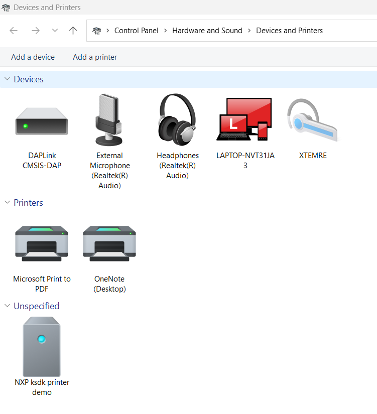

I loaded the example code given to connect USB virtual printer. The code compiles properly giving no errors. But when the code is loaded, the expected functionality doesn't take place. The overview of the full example project and expected functionality is explained in the attached pdf.
The example project name is "dev_printer_virtual_text_bm_cm7"

More specifically the problem I have is, according to the documentation given, a software should installed automatically after running the code. But when I am running the code, the expected software does not get installed. Thats problem now I am dealing with. iMXRT1170

I ran the code again and followed following steps,
      in device manager following icons were displayed,
After that I updated the drivers both ways, manually and by clicking on "let me pick"
But even after doing that, still generic printer is not shown in the printer section,
And when I go to devices and printers folder, it shows like this,
Can u suggest what can I do to fix this issue. In addition I have a doubt to clear out. The printing process that we going to do here is fully virtual one instead of physical one. Am I right ?
