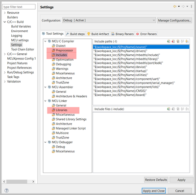

For MCUXpresso project migration I recommend to start in a clean RT1064 project, the starting point it could be one from USB and freeRTOS. Below I wrote some general migration guidelines from my experience.
1 Copy RT1060 tethering folders and source files and  paste them in your project. Make sure that folders are not excluded from build.  Untick this option in folder properties.
2 I usually check original project settigns and I try to use the same on the target migration project. Below the most common ones.
    Project properties >settings >tool settings > preprocesor, includes libraries
3 From project properties >settings >tool settings > also check   Manage linker script , for more advanced linker settings and also check optimization.
4 Check memory layout project properties > MCU settings.
4 With MCUxpresso SDK component manager pull required/missing  application drivers.
5 Review MPU settings, Board, clock and pin settings. Sometimes SDK projects are using Config tools to clock, peripheral settings.
6 Review (USB) applicaiton  settings.
