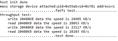

Setup 1, Original RT1170 SDK example
  1. Import SDK example host_msd_fatfst_freertos_cm7.
  2. Change  MCU_CORE_CLOCK from 120000000 to 998000000 to reflect the correct CPU core clock frequency.
  3. Change MSD_FATFS_THROUGHPUT_TEST_ENABLE from 0 to 1 so the code will measure USB MSD read and write speed.

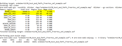

  4. Build the project. The code is XIP from the NOR flash. BSS segment, stack and heap are put on the DTC.
  5. Debug the project on RT1170 EVK. I also need to connect a USB flash drive to micro USB1 (J20) on RT1170 EVK.

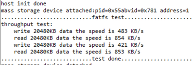

  6. The following results are printed on debug console. The read speed is around 25MB/s.

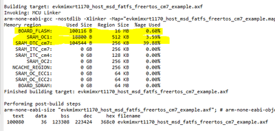

Setup 2, Original example + BSS segment, stack and heap in OCSRAM (set to non-cacheable)
  1. Same as Setup 1 step 1.
  2. Same as Setup 1 step 2
  3. Same as Setup 1 step 3.

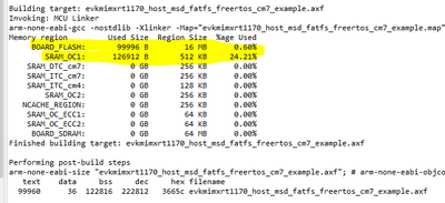

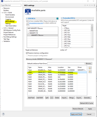

  4. Move SRAM_OC1 to first RAM option in the table of MCU setting.

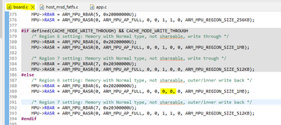

  5. Disable the cache on OCRAM by changing the value in board.c file from 1 to 0 as highlighted in the following
  6. Build the project. The code is XIP from the NOR flash. BSS segment, stack and heap are put on the OCSRAM.
  7. Debug the project on RT1170 EVK. I also need to connect a USB flash drive to micro USB1 (J20) on RT1170 EVK.
  8. The following results are printed on debug console. The read speed is around 22MB/s.

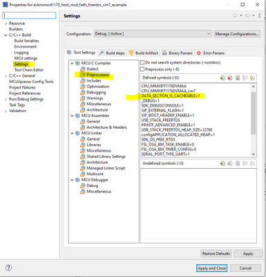

  5. Set DATA_SECTION_IS_CACHEABLE=1 in preprocessor.

  8. The following results are printed on debug console. The read speed is less than 0.5MB/s. I do not think this speed is normal with cache enabled. What have I got wrong?
