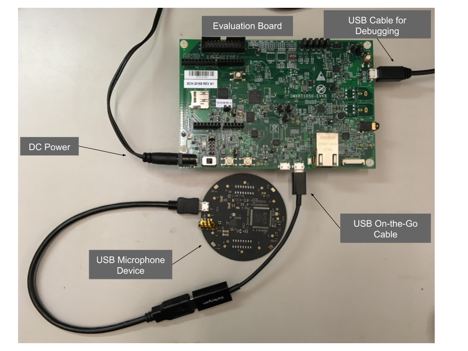

Setup Details
My RT1050 is setup as a USB Audio Host. I created the USB Audio setup based off of the USB HID Mouse example. I included the state machine below that sets the control and streaming interfaces.
I'm able to receive audio data from a connected Full-Speed USB microphone by repeatedly calling USB_HostAudioStreamRecv.
Test Setup and Results
I have results from two different ways of using the USBHostAudioStreamRecv function that both result in receiving unexpected audio data. In these tests, I'm speaking into the microphone and collecting three seconds of audio data into a RAM buffer on the RT1050. At the same time, I'm collecting a trace of the USB communication using a Teledyne Advisor T3 USB Analyzer.

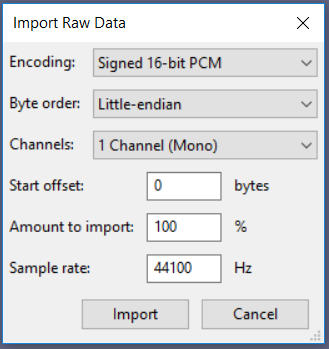

Here are descriptions of the two modes of operation. The audio bin files are 16-bit, 16kHz PCM audio, which can be played using Audacity.
Mode 1: More than one packet (greater than 34 bytes) is requested for transfer at a time
USB Trace of Audio: microphone_4k_read_usb_trace.bin.zip
Received data on RT1050 read from RAM buffer: microphone_4k_read_ram_buffer.bin.zip
a) AUDIO_BUFFER_SIZE = 34
b) The received audio’s speech is audible, but there is significant noise
c) In this mode, the audio data on the bus is equivalent to the audio data of the source (microphone)
d) Comparing the received data to the source data, bytes are rearranged and values are different
Mode 2: Exactly one packet (34 bytes) is requested for transfer at a time
USB Trace of Audio: microphone_34_read_usb_trace.bin.zip
Received data on RT1050 read from RAM buffer: microphone_34_read_ram_buffer.bin.zip
a) AUDIO_BUFFER_SIZE = 4096
b) The received audio does not resemble speech
c) The audio data recorded on the bus does not match the audio data of the source (microphone)!
d) One isochronous transaction occurs every 3ms, instead of the expected 1ms (Full Speed)
e) It seems there’s a delay in the stack that is preventing the reads from happening fast enough

I've attached an updated version of the USB Host Audio project that can be used to reproduce the issue on an evaluation board.
The update includes a large buffer (_audioPlaybackBuffer in host_audio.c) for collecting received audio data. Once the buffer is full, all of the audio data that has been received by the USB Audio Host can be viewed or exported to a binary file.
The audio software Audacity can be used to play the binary file as audio (File -> Import -> Raw Data...).

amwilhite
50,910 Views
fangfang
Thanks for your information and I will forward to it. I get the feedback as the below:
Now I can run the customer code, but no proper device to make the test.
What I can think of is to use our usb_device_audio_generator demo as a MIC.
But customer code does not work in this case.
Is it possible to ask customer to test usb_device_audio_generator demo ?
If this issue can be seen on usb_device_audio_generator demo, we can analysis.
Please let me know if have the issue for the usb_device_audio_generator demo. Thanks.
