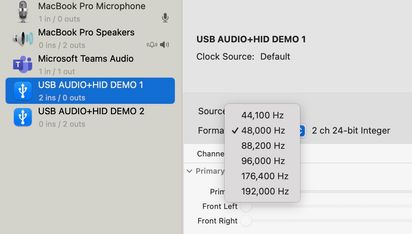

EdwinHz
Hi @paulw2,
While investigating about this issue, I encountered an old project based on SDK 2.8.0 that provides a host with a list of supported sample frequencies. Although older, I believe it can prove to be very useful for your application. I will attach here. Notice how the freqControlRange structure is expanded to include a wide range of frequencies:
    g_deviceAudioComposite->audioUnified.freqControlRange1.wNumSubRanges = 6U;
    g_deviceAudioComposite->audioUnified.freqControlRange1.wMIN          = 44100U;
    g_deviceAudioComposite->audioUnified.freqControlRange1.wMAX          = 44100U;
    g_deviceAudioComposite->audioUnified.freqControlRange1.wRES          = 0U;
    g_deviceAudioComposite->audioUnified.freqControlRange2.wMIN          = 48000U;
    g_deviceAudioComposite->audioUnified.freqControlRange2.wMAX          = 48000U;
    g_deviceAudioComposite->audioUnified.freqControlRange2.wRES          = 0U;
    g_deviceAudioComposite->audioUnified.freqControlRange3.wMIN          = 88200U;
    g_deviceAudioComposite->audioUnified.freqControlRange3.wMAX          = 88200U;
    g_deviceAudioComposite->audioUnified.freqControlRange3.wRES          = 0U;
    g_deviceAudioComposite->audioUnified.freqControlRange4.wMIN          = 96000U;
    g_deviceAudioComposite->audioUnified.freqControlRange4.wMAX          = 96000U;
    g_deviceAudioComposite->audioUnified.freqControlRange4.wRES          = 0U;
    g_deviceAudioComposite->audioUnified.freqControlRange5.wMIN          = 176400U;
    g_deviceAudioComposite->audioUnified.freqControlRange5.wMAX          = 176400U;
    g_deviceAudioComposite->audioUnified.freqControlRange5.wRES          = 0U;
    g_deviceAudioComposite->audioUnified.freqControlRange6.wMIN          = 192000U;
    g_deviceAudioComposite->audioUnified.freqControlRange6.wMAX          = 192000U;
    g_deviceAudioComposite->audioUnified.freqControlRange6.wRES          = 0U;
If you wish to quickly test, you could download SDK2.8.0 and build with said SDK for your RT1010. Otherwise, I would recommend you port this implementation to your needs on the latest SDK2.16.0 for the best performance.
BR,
Edwin.

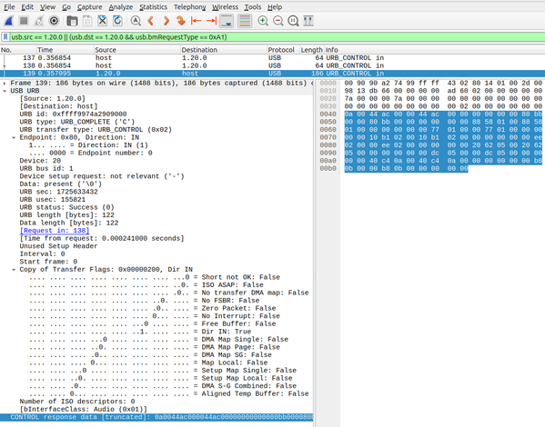

paulw2
Hi @EdwinHz
Apologies for this delayed reply, I've been away from NXP SDK for a while.
I tested this example app as is, with SDK 2.8.
Once I figure out which of the changes it introduces I require, I'll port them to the current SDK.
It enumerates as follows :-
$ lsusb -vd 1fc9:0032
Bus 001 Device 009: ID 1fc9:0032 NXP Semiconductors USB AUDIO+HID DEMO
Couldn't open device, some information will be missing
Device Descriptor:
  bLength                18

I used Wireshark to capture the USB traffic for a known good UAC 2 device which enumerates as supporting the following sample rates.
host requests sample rate rangehost requests sample rate range
audio device responds with sample rate rangeaudio device responds with sample rate range
That CONTROL response date decodes as follows :-
numSubRanges
0x0a 00
min max res
0x44 ac 00 00, 44 ac 00 00, 00 00 00 00 - 44100 kHz
0x80 bb 00 00, 80 bb 00 00, 00 00 00 00 - 48000 kHz
0x88 58 01 00, 88 58 01 00, 00 00 00 00 - 88200 kHz
0x00 77 01 00, 00 77 01 00, 00 00 00 00 - 96000 kHz
0x10 b1 02 00, 10 b1 02 00, 00 00 00 00 - 176400 kHz
0x00 ee 02 00, 00 ee 02 00, 00 00 00 00 - 192000 kHz
0x20 62 05 00, 20 62 05 00, 00 00 00 00 - 352800 kHz
0x00 dc 05 00, 00 dc 05 00, 00 00 00 00 - 384000 kHz
0x40 c4 0a 00, 40 c4 0a 00, 00 00 00 00 - 705600 kHz
0x00 b8 0b 00, 00 b8 0b 00, 00 00 00 00 - 768000 kHz
This seems to align with the structure of the sample rate data of the example you have provided.
