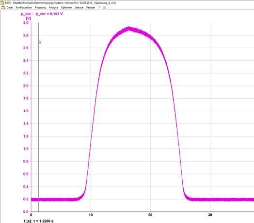

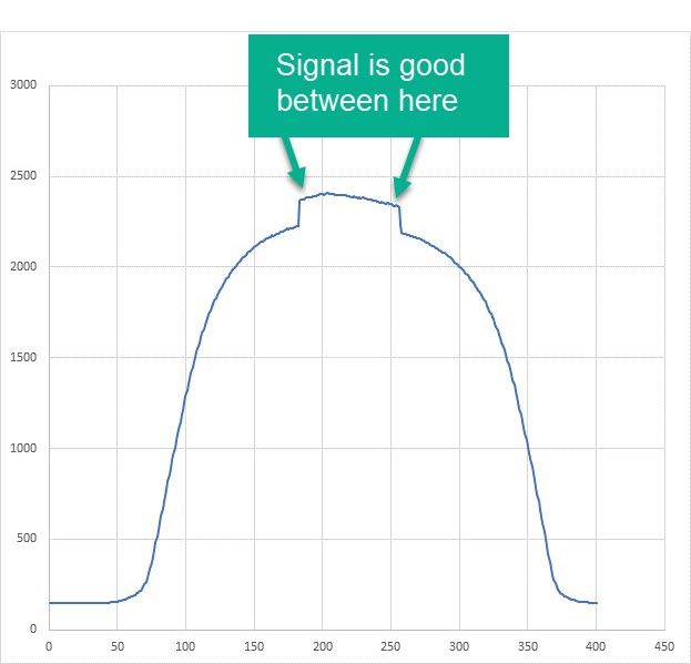

Wenn we measure with ADC the signals makes a jump than it reaches a certain level.
First picture shows ADC result values (increments). The second is a measurement of the analoge input signal at the same time at the input of the operational amplifier (signal "SENSOR_1"). There is no jump to observe.
Signal "ADC1_CH00_SENSOR1" (=µC input) is not only defined by the voltage divider in the schematics. It seems that there is an additional e.g. 100 k pull down in the µC. And then it reaches a certain level, this internal resistor seems to be switched of. The signals jumps to its expected value.
We think that this is a configuration error but we can't figure out. There is no option "No internal resistor". 1 pull down, a few pull up and "No Init". "No init" does not sound as a valid option and may cause in random results. (though I will test this next).

The problem is caused by the setting Pull/Keeper Enable = true.
This was the default setting. Just for my understanding: What is the background of this setting for an analog input?
Pull down / up are an unwanted loads and skew the measurement. Keeper as far as I understand are only useful for digital outputs.

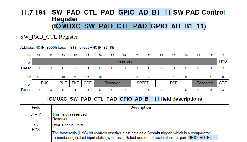

  In factor, register OMUXC_SW_PAD_CTL_PAD_xx_xx already give the default value, take GPIO_AD_B1_11 as an example:
So, if your application don't need the internal pull/keep circuit, you can disable it. DSE you can set to 000, ODE you also can set it to 0. Normally, when you configure the related modules, you need to configure the IOMUXC pins register at first.
