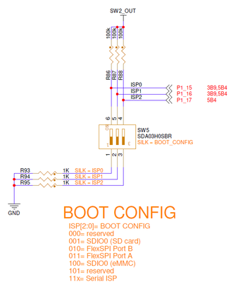

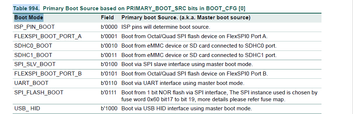

Could you let me know whether you are using an NXP development board or a customized board? What is the flash type, and what are the boot mode and ISP pin configurations?

Is a custom evk, we are interfacing with the issi NOR type flash is25wx256-jhle in octal DDR mode booting from flexspi A.
My main goal is to first get rid of the use of secure provisioning tool for this and only use mcu xpresso, seems to be easier to use jlink flash than a nxp mcu link / cmsis-dap probe.
