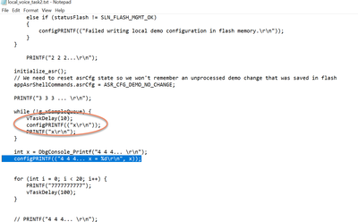

Hello all,
I have an issue with serial output PRINTF macro in a task suddenly stops working, in the below code, after serial output with "x" chars in while loop, I don't get any further output on UART.
I did set a breakpoint in DbgConsole_Printf("4 4 4...\r\n") line and debugger stops and prints correctly that 11 chars have been written in return value of function, so I suppose that functions gets executed, but unfortunately I do not see any output in UART6 aafter output of the "x" chars in while loop.
So I'd be glad for any pointers how to debug this further as I am out of ideas for now.
Thanks & Regards,
Lorky

the PRINTF() outputs you mentioned was to check only how far PRINTF() output is working in loval_voice_task(), and after printing 3-4 'X' chars, I verified with debugger that code executes into while(1) loop.
So I do get all PRINTF() outputs until PRINTF("X \r\n") and no further outputs below, especially the needed output for recognized commands (see attached code excerpt of local_voice_task() function, needed output is in lines 189/190 and 200/201:
configPRINTF(("%d\r\n", vocal2code(pInfCMD->iWhoAmI_lang, g_asrControl.result.keywordID[1])));
configPRINTF(("TEST\r\n"));
PRINTF("%d\r\n", vocal2code(pInfCMD->iWhoAmI_lang, g_asrControl.result.keywordID[1]));
PRINTF("TEST\r\n");

  From your test result, the code should run in the following code:
After sendout some X, then it may works in other task wait something.
Why you use this method to test the code?
If you want to debug, I highly recommend you use the JLINK as the debugger, then you can trace the code more clearly.
