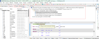

mayliu1
Dear @hanmant ,
Thanks for the update.
you said your whole application got stuck when you add the functions.
Can you tell me the detail information when your whole application got stuck.
1: where your application got stuck, Please tell me which function.
2: when your application got stuck, Please read your RT1020 Registers, Faults, Peripherals status, check whether something unusual.
The following Fig is just a demo to help you check the problem.
Wish it helps you!
Best Regards
mayliu

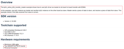

mayliu1
Hi @hanmant ,
I do not think this problem related with current case subject" UART3 overrun error occurs RT1020".
I import SDK demo as you do, I find that this demo "lpi2c_edma_b2b_transfer_master" need  lpi2c instance on the other board as slave.
Because of no I2C slave,  lpi2c_master_callback can not be called, so you application got stuck.
mayliu
4,253 Views

mayliu1
Hi @hanmant ,
Thanks for your update.
The reason of your Application got stuck  is the I2C master node of your development board needs to be connected to the I2C slave node.
I verified it with my development board, and if I don't connect to the I2C slave node, I get an error  as you. If I use two development board, one is "lpi2c_edma_b2b_transfer_master", the other is "lpi2c_edma_b2b_transfer_slave". connect two boards correctly, the program run well.
You can create a "lpi2c_edma_b2b_transfer_master" project and don't add any other code to validate.
Best Regards
mayliu
