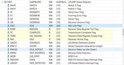

I'm using uart3 interrupt of RT1020 ,i'm using uart3 for rs-485 communication and its speed is 3MBps.
Also, I'm using LPSPI4 CMSIS driver handler for other communication .
Individually uart3 works fine but after adding spi handler , it will start occurring Overrun.
Still im clearing overrun flag but why this flag is getting set .
Also ,one query when this flag set ,in this case will i receive all data or lost

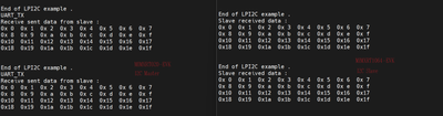

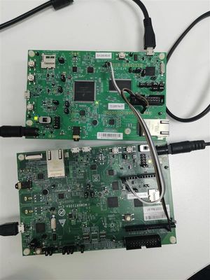

Hi @hanmant ,
I use MIMXRT1020-EVK board  as edma_b2b_transfer_master, MIMXRT1064-EVK board as edma_b2b_transfer_slave.
I create a project based on  MIMXRT1020-EVK board, I set this board as I2C master, add UART TX, UART RX, totally using 4 DMA channels.   I modify some code  both of MIMXRT1020-EVK project  and MIMXRT1064-EVK project.
The result is both projects run Okay.
So please check your code, the critical code I have shown you bellow.
Please try it, and tell me to close this case.
If you still have question, Please create a new case.
mayliu

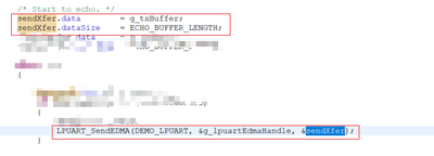

mayliu1
Hi @hanmant
Thank you for your updated information.
As you said, if you only send UART data, why you ask me UART overrun error happened.
UART overrun error is related with UART receive.
and if you want to send UART data, It is very simple, just call LPUART_SendEDMA.
mayliu

hanmant
Hi @mayliu1 ,
Thanks for reply.
As of now im not using uart receiver .
whatever i shared with is only uart transmit only (size 52 buffer)but i dont receive correct data on my Ti board using dma.
14,018 Views

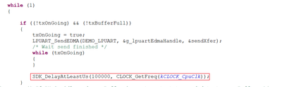

mayliu1
Hi @hanmant
I think I know the reason of the problem.
Continuous data transmission in your program can cause Ti board UART receiver overrun, resulting in abnormal data transfer.
I suggest adding a delay after sending 52 bytes UART data, Please try it.
I have tested and verified this 100 times on my end, and the data sending and receiving are consistent.
Wish it helps you.

mayliu1
Hi @hanmant
Just add a delay function, I have shown to you.
SDK_DelayAtLeastUs(100000, CLOCK_GetFreq(kCLOCK_CpuClk));
1:In addition, I suggest you check whether the data format for UART sending and receiving is consistent.
2:Please confirm whether your NXP development board and TI development board share a common ground.
3:Please confirm whether the connection between UART transmission and reception is secure.
mayliu

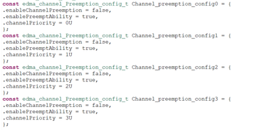

hanmant
Hi @mayliu,
Can you please tell me how to set Highest the Priority to DMA controller over CPU.
Also in DMA i want set the highest priority to UART receive and TX than SPI.
Please tell me the process and API's or any examples.
13,777 Views

hanmant
Hi @mayliu,
I'm thinking add this way,
const edma_channel_Preemption_config_t Channel_preemption_config = {
.enableChannelPreemption = false,
.enablePreemptAbility = true,
.channelPriority = 14U
const edma_channel_Preemption_config_t Channel14_preemption_config = {
.channelPriority = 15U
EDMA_SetChannelPreemptionConfig(EXAMPLE_LPUART_DMA_BASEADDR,LPUART_TX_DMA_CHANNEL, &Channel_preemption_config);
EDMA_SetChannelPreemptionConfig(EXAMPLE_LPUART_DMA_BASEADDR, LPUART_RX_DMA_CHANNEL, &Channel14_preemption_config);
is it correct or not.
please confirm
13,764 Views
mayliu1
Hi @hanmant ,
Please review the differences between the following definitions and use them according to your needs.
EDMA_SetChannelPreemptionConfig: It is primarily used to configure the preemption priority of DMA channels, ensuring the most important task can be processed first, when multiple DMA tasks happened at the same time.
NVIC_SetPriority:  It is used to set the priority of interrupts, ensuring that high-priority interrupts can be responded to and processed by the CPU first when multiple interrupts happened at the same time.
Best Regards
mayliu
13,761 Views
