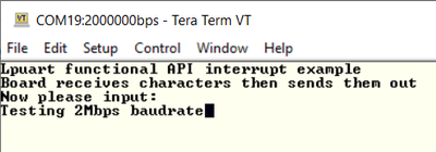

  1. UART clock selection only 2 ways (OSC  & PLL3)..(80MHz, 24MHz)..   Any other clock root changes or not?
  2. Max Baudrate upto 5Mbps for Clock Selection was 80MHz, but in my case after 1.5 Mbps baudrate it does not support Transmission & Reception...

Hello!
Please see my answers below.
1. No, those are the available clock sources.
2. I tested 2 Mbps with my board and it worked correctly, I used lpuart_interrupt example and TeraTerm. Please check it below.
Felipe

I installed Tera Term Software, but maximum baudrate for serial port was 921600, How did you get 2000000 baudarte
3,198 次查看
FelipeGarcia
You can manually write it even though there is no 2 Mbps option.
Felipe
