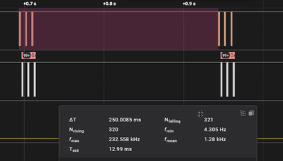

Hi!
im working on a project using RT1064 the LPUART1 with a Baudrate of 460800
In my project, I'm receiving data from five slave devices. The microcontroller sends a request consisting of 91 bytes, and it checks for available data using the function getUartNumberOfBytesToRead. Upon detection of data, the program jumps to the custom function receiveUart() to read the reply from the slave device. This process is repeated for all five devices

However, during testing with three devices, I observed an issue. The devices are expected to send back 85 bytes of non-zero data as part of a protocol. Although the size of the received data remains correct at 85 bytes, the actual data itself is intermittently being read as zeros or getting cut off.
more context: the three packets of data being sent are repeated every 250ms as shown below
a single paket takes around 2ms
I'm interested in determining whether there's a method to check for data corruption in the receive register of the LPUART. Additionally, I'd like to know if data corruption in the receive register is a common issue. Thanks.
I need assistance in resolving this problem
