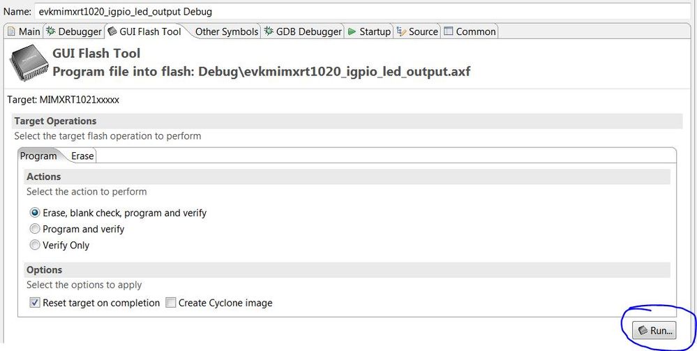

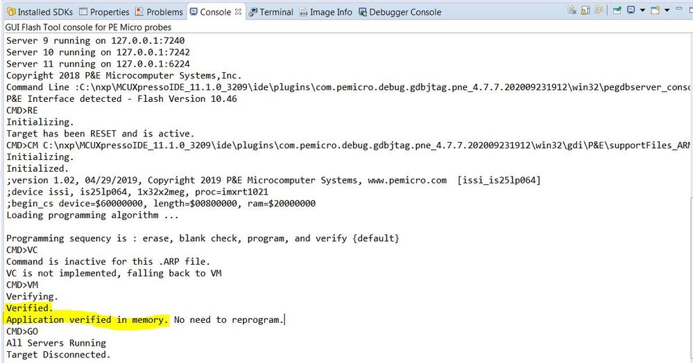

The flash seems to be programming as I see the results by watching the console output when running the GUI Flash Tool:

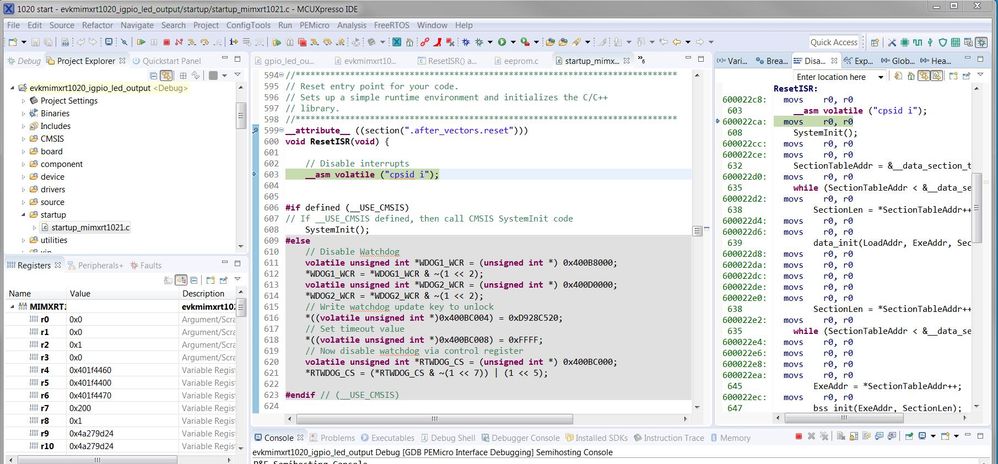

When I try to debug using a PEMicro Universal Multilink FX , something is going wrong.
When I start debugging, the contents of the memory addresses do not match what should be programmed; i just see a series of mov instructions. Please see in the picture below. I put a break point in the startup code:

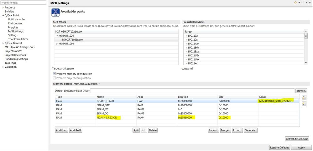

I did read another persons post with a similar problem and followed their fix, unfortunately this did not work for me. First I changed the flash driver to the generic one and modified the memory configuration.

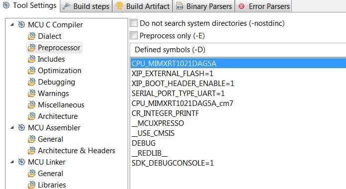

To reduce the clutter I have reverted to a small example code supplied with the SDK called evkmimxrt1020_igpio_led_output. With the aforementioned modifications this code runs on the eval board but not on my target.
Here are my processor settings:
