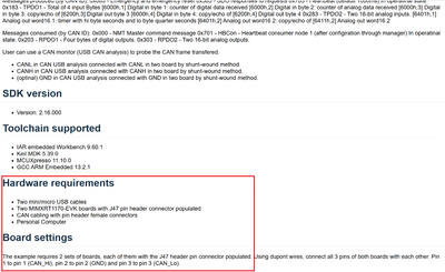

Did you follow user manual or steps from Readme.md before you ask this question?
Especially for hardware and board setting.

So even you follow up the steps as README shown, this demo/example(NO ANY Modification) is still not workable from your side? If yes, please clarify in details.
