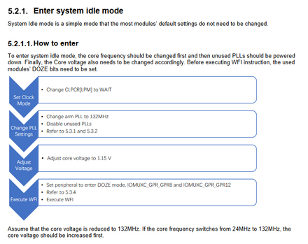

Please follow these steps, it is important to set DOZE mode:
Additionally, make sure that there is no pending interruption when entering in that power mode.

We have gone through the application note as well as taken reference from SDK.
We are disabling the interrupts as well as disabling Systick so that it may not cause any issue.
On analysis we observed that while executuing __WFI(), it is not waiting for wakeup source to generate interrupt but watchdog is resetting the system.
We tried disabling the watching before calling __WFI(), but the watchdog is not getting disabled.
