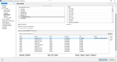

ManikantaRobbi
“.boot_xxx” sections. i.e Is it necessary to change the boot switches from internal boot mode. while using cm4 project to use flash memory 0x0800_0000.
3,212 Views
ManikantaRobbi
Hi @Masmiseim ,
Thanks for the information. I had followed the instructions for mem config. Image attached reflects the changes done in memory "0x30100000"  and the project created for CM4. But again I'm getting build failed.
This is log message after build.
So can't we create a new project for CM4 access the QSPI.
Manikanta Robbi.

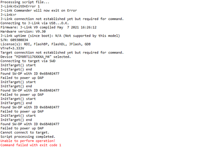

3,201 Views
Masmiseim
Senior Contributor I
Looks to me like a problem with the JTAG connection. Does a connect via J-Link Commander to the M4 core of the iMXRT1170 work?
