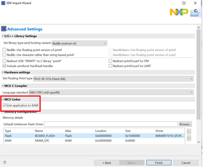

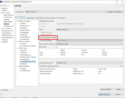

To run your application on RAM you have two options:
-You can change your project to run in RAM enabling this box when you create a new project:
-If you already have a created project, you can enable this box in properties:
Also, if you experience any issue, do not hesitate to let me know.
Habib.

     With "Link Application to RAM" setting, When board is power off and on then my application doesn't run. So this setting doesn't work for me.
Our board has external QSPI Flash to store the  code image.  During power on BootROM should copy code image from flash to ITCM RAM.
I am using dual cores CM7, CM4 in project. CM4 anyway runs in its RAM(ITCM_CM4). But i am looking for CM7 code, should also be executed from ITCM_CM7.
Please suggest.
