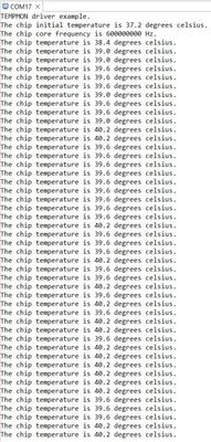

Regarding the first matter my results with the same methodology that you are using are the following at an environmental temperature of 25/27C°.
Once it reaches 40.2°C I let it run for approximately 20min and it reaches 42.7°C.
Still, let me check your case with our applications team, to see what comments they have about your reading of 18°C at an environmental temperature of 26/27C°.
