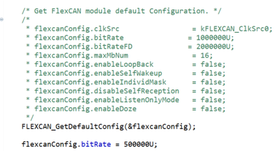

We are using CAN3 module in imxrt1176 controller.
To test the CAN operation we are connect CAN_HI, CAN_LO, GND of one board to another board respectively and used the FlexCan SDK example and the single byte of Data is transfered between the 2 boards.
What is the speed of CAN used in this example code for imxrt1176 controller using FlexCan

You can check the default configuration of the FlexCan in a comment on any SDK example for FlexCAN, for example flexcan_interrupt:
