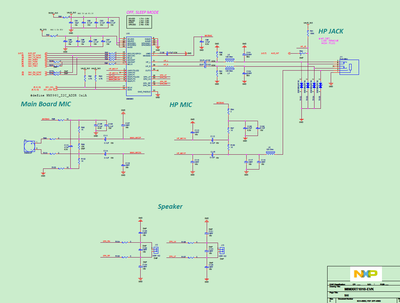

   I2S(SAI) code is for the interface, but in normal usage, eg, use the speaker, or mic, you still need to use the codec, please check the MIMXRT1010-EVK board:
So, w8960 is used to configure the codec.
