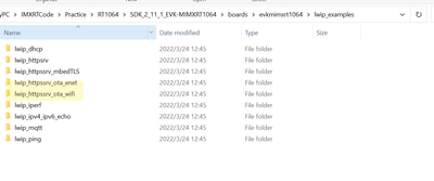

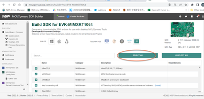

Hi @ulivinico1 ,
You lack the code, it should be caused by you didn't select all the middleware when you generate the SDK:
https://mcuxpresso.nxp.com/en/builder?hw=EVK-MIMXRT1064
Please select ALL, then download the package again.
You will find it.
Wish it helps you!

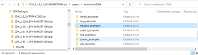

ulivinico1
@kerryzhou
It looks like mcuboot_opensource folder is missing in my package, tha't why I don't understand how to refer to it.

kerryzhou
Hi @ulivinico1 ,
You will find it.
Wish it helps you!
