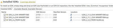

  Which SDK version you are using now?
This one?
About the bootloader, you need to refer to this one:
SDK_2_11_1_EVK-MIMXRT1064\boards\evkmimxrt1064\mcuboot_opensource\readme, you need to use the tool to download the signed image, more details, check the demo readme.txt.
kerry
2,839 次查看
ulivinico1
Hi @kerryzhou
"Which SDK version you are using now?"
I'm using 2.11.1

2,835 次查看
ulivinico1
@kerryzhou
It looks like mcuboot_opensource folder is missing in my package, tha't why I don't understand how to refer to it.
2,824 次查看
kerryzhou
Hi @ulivinico1 ,
You lack the code, it should be caused by you didn't select all the middleware when you generate the SDK:
https://mcuxpresso.nxp.com/en/builder?hw=EVK-MIMXRT1064
Please select ALL, then download the package again.
You will find it.
Wish it helps you!
kerry
