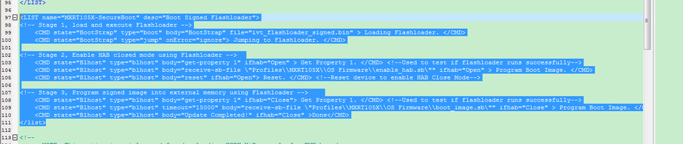

We are running into a problem in RT1052 platform, my software system is bootloader + application, run as XIP, which both reside in flash but not next to each other. After running bootloader, MCU will jump to application area to run.
Bootloader has been encrypted by HAB signature, but which encryption method is available for my application? After reading your AN12079, I have some questions:
1. if BEE encryption (encrypt/decrypt XIP) has been applied on the application, can I download a plain image and debug it in this area by JTAG?
2. Does encrypt XIP happen at bootable image download?
3. If the application is only encrypted by signature, is it possible to make bootloader tell MCU to check the signature before jumping?
I just want to figure out how to encrypt a XIP application, any suggestions? Thank you!

1. This is my understanding of XIP encryption process, is it correct?
    1) PC side: an unsigned image (plain image) ->add BEE configuration->.sb file (it isn't encrypted)
    2) download process: .sb file is being downloaded to flash, but data belonging to the ranges of BEE indicated will be encrypted while writing, so the file in flash would be different from the original one ( in step 1)
    3) bootup process: after a reboot, MCU will run the image, but once it runs code belonging to the special ranges must be decrypted firstly.
Answer: The PC side use the unsigned image, then it should add the BEE encrypted code, then download the encrypted code directly. You have checked AN12079, you can find when generate the .sb files, it is using:
elftosb.exe -f kinetis -V -c program_flexspinor_image_hyperflash_encrypt.bd -o boot_image.sb ivt_application_unsigned_nopadding.bin
It means, the boot_image.sb already the encrypted code, then use the MFGtool, just need to download the code.
You can find when do the download, it just download  the flashloader, the fuse and the .sb files.
This is my understanding. If you have the interest, you also can try the BEE encrypted operation details, then check each steps generated files, and compare with your last downloaded and flash readout memory. You can check my HAB operation process, may useful to your understanding:
RT1050 HAB Encrypted Image Generation and Analysis
BEE is simliar.
  When do the BEE boot, the spcial ranges which is encrypted must do decrypted at first. BEE is runing while decrypted directly. Not like the HAB encrypted, which will copy to the internal RAM, and do the decrypted, then run from RAM driectly.
2. My bootloader did have done the HAB signature and run in flash as XIP, yes, flashloader was signed as well, but it did run as XIP. So according to your answers, it seems APP couldn't do signature encryption, because it needs a signed flashloader to work together, and only ROM code can do that, am I right?
Answer:  Please note, HAB signature and encrypted just to the Non XIP code. If it is the XIP code, you need to use the BEE. Non XIP code means the real app code in the internal RAM. The signed flashloader needs the ROM code to do it.
Wish it helps you!
Kerry
Answer: If you do the HAB signature, the code should be Non XIP code, which should run in the RAM, you can refer to the AN12681 and AN12079, you can find the flashloader also need to do the signed operation at first.
If you want to just do the app firmware encrypted, you can use the MCUbootUtility tool just select the related app image address do the BEE encrypted operation.
Wish it helps you!
If you still have questions about it, please kindly let me know.
Kerry
