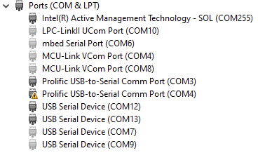

When using multiple debug adapters with multiple boards, it's useful that the COM ports do not move around. I have multiple boards (custom, and EVKs) connected at once.
Another issue: the driver improperly selected COM4, a port that was previously assigned, but not active.
When I activated it (via USB HUB switch), the original device could not start because of the overlap.
You can see that problem below.
I tried uninstalling the MCU-Link on COM4. When I cycled it's power, it returned to COM4, this time overlapping the active COM4 device.
Is there any possibility NXP's driver can be corrected to fix this selection problem?

jeremyzhou
According to the reply of the MCU-Link team, they were able to confirm that the missing Port Settings tab in the device managers properties is an oversight of the MCU-Link VCOM driver.
And they will fix the bug in a subsequent MCU-Link firmware update utility package (which includes and installs the necessary device drivers on Windows).
